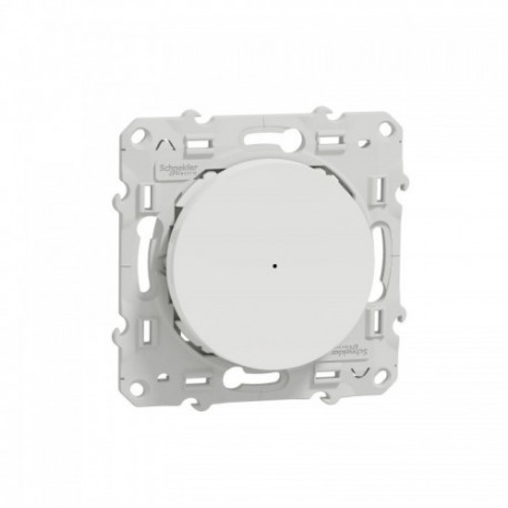

Otherwise look for switches which use zigbee HA 1.2. Schneider and Sunricher both have some for the EU. They make both zwave and zigbee models, so check the product descriptions carefully. However, they may require custom code to work with SmartThings.

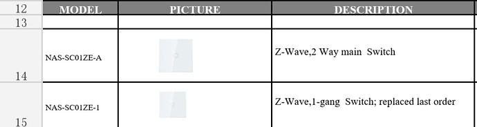

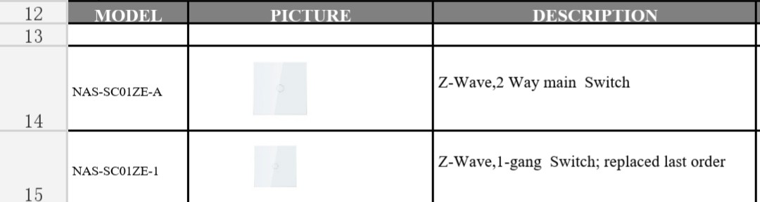

Their description of the setup is “function same as picture such as :
A Switch is main one with Rely and turn on/off
B Switch is only turn on/off , but without Rely .”
