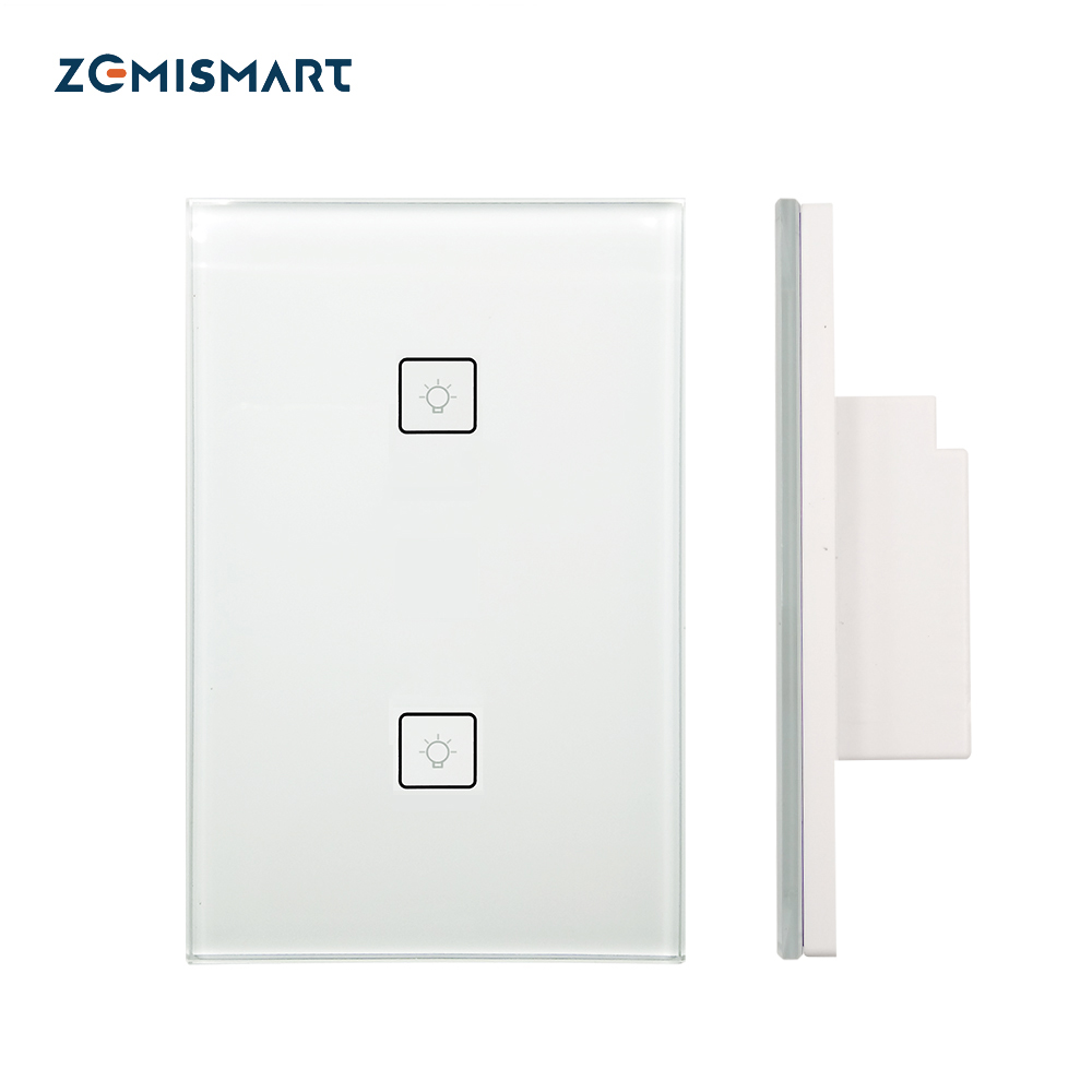

Hi I ordered 1,2 and 3 gangs switch from Zemismart all work well with DH and SmartApp they provide. About the repeater functionality, I’m not sure how to check. On the box of 2 gang, it said ZibBee 3.0 while on 3 gangs said ZigBee-ZHA/ZLL. The data on the switch shown as a router.

And for a 3 gangs switch? As Zigbee Multi Switch just 2 are recognized.
Tks
An other point.
As Zigbee switch execution location is local. As Zigbee multi switch, execution location is cloud. Is there any way to recognize 3 gang switch and execute local?
