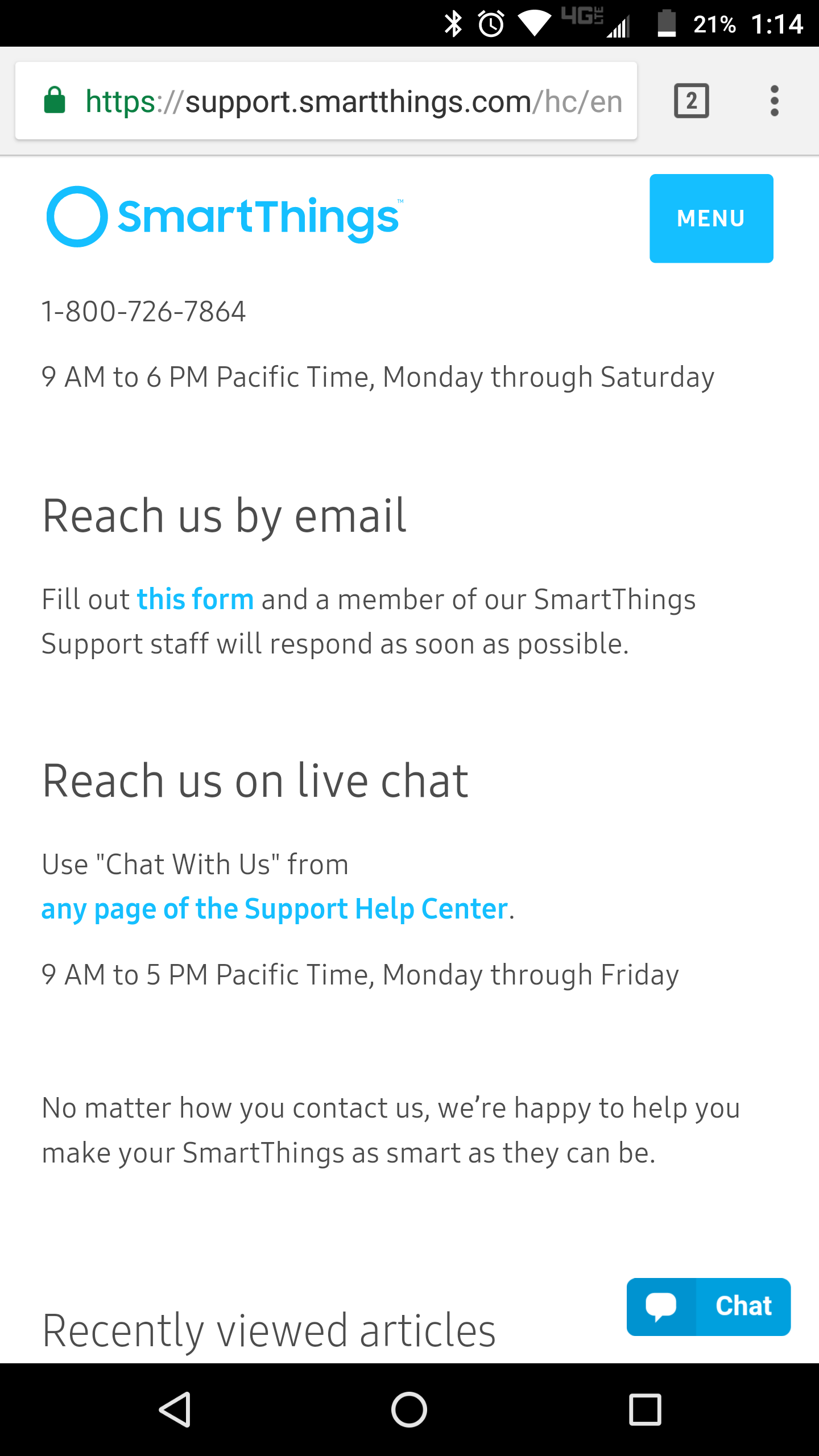

What time zone are you in Steve?
Get on Live chat and they will help you immediately version waiting for the email side.
