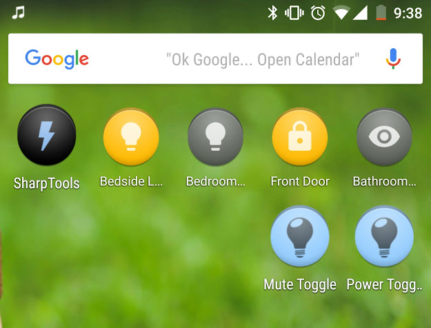

@seahawk What kind of mobile device do you have? (eg. iOS or Android)
Using SharpTools (on Android), you can do some cool things with Kristopher’s device type like creating widgets to control your receiver, creating notifications to display the state + quick actions, or using ā€œOK Googleā€ voice commands to control the receiver.
