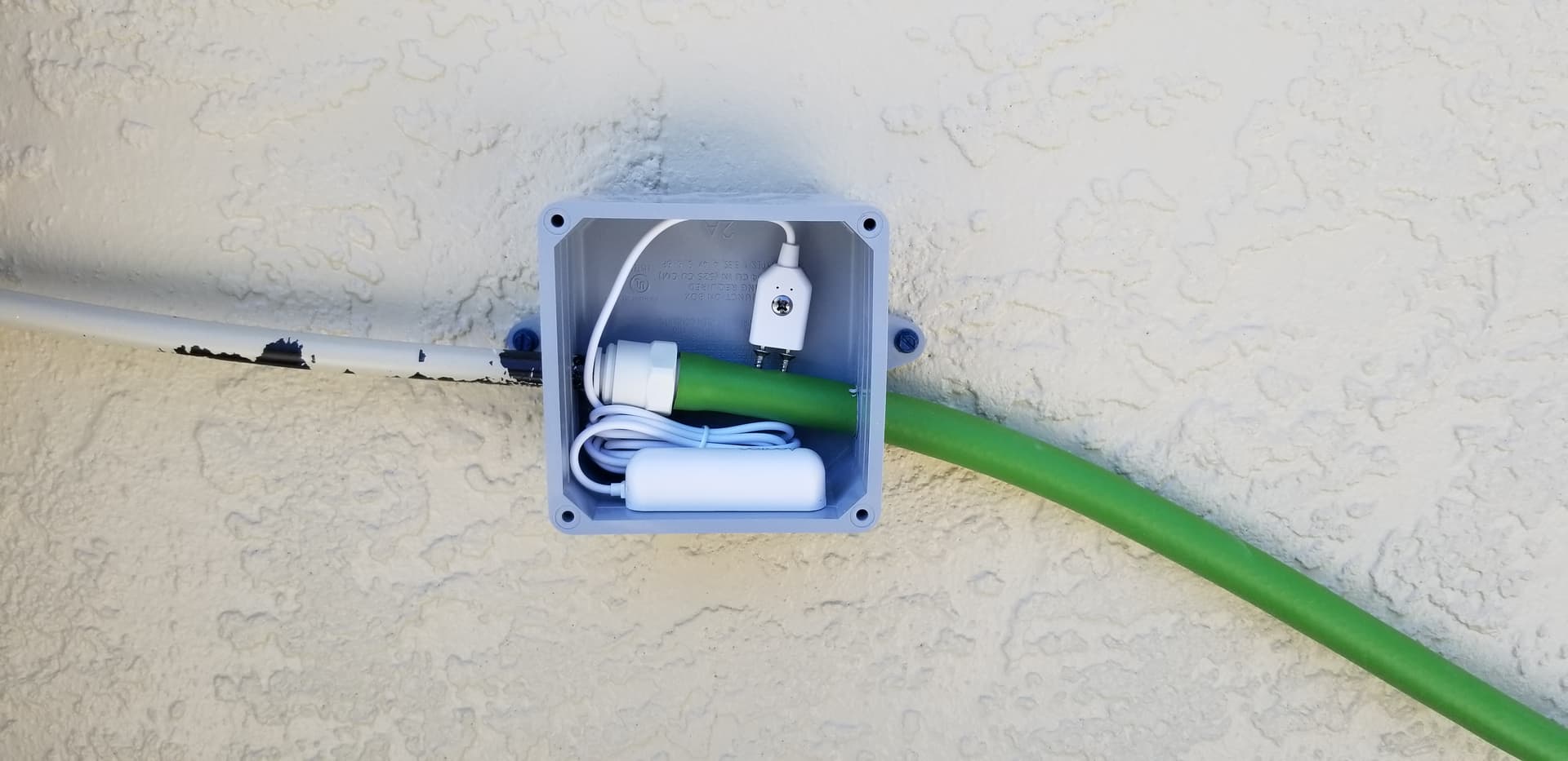

I’ve thought about the rain/weather and considering to install the tube and sensor inside a Cantex box and attach it to the side of the house.

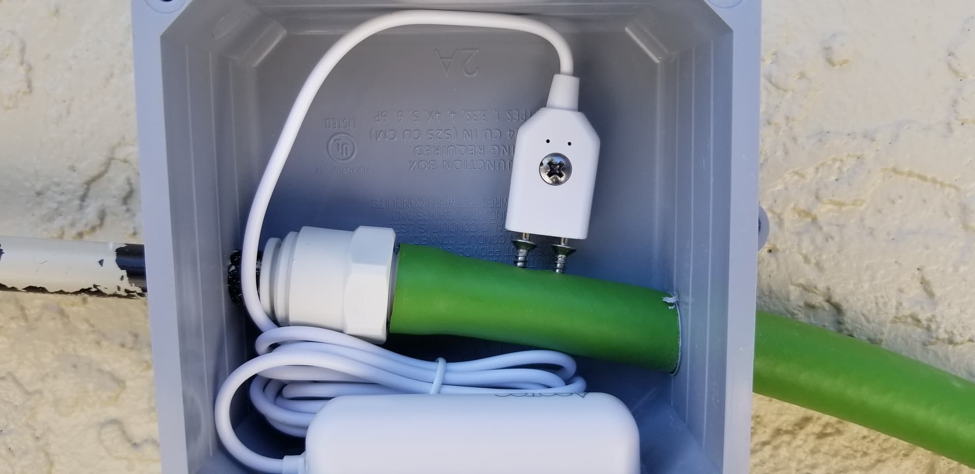

I ended up using the Aeotec Water Sensor 7. They changed the probes to shorter ones, so I used stainless steel screws as probes into the hose.
The existing 3/8" hose from the water softener was constantly giving me a “wet” signal on the Aeotec. I surmise that there was still a little bit of water sitting in the hose that was creating the connection. Once I installed the screws to the 1/2" hose, it only acknowledges the “wet” condition when the softener is actively in regen.
