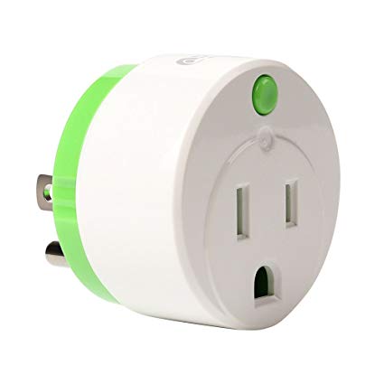

How Many Sockets?
Other features which differ by model include the number of sockets, whether the sockets can be controlled individually or only in unison, and whether there is an additional USB charging port. (That’s unlikely to be controllable, but it can be convenient to have.)
Dimmable or not?
There are only a few Z wave pocket sockets which are dimmable because of fear that people will plug a small appliance into them, but there are a couple if you want one of those for a table lamp.
Other features
And of course the size, shape, and price can vary quite a bit as well. “Stackable” pocketsockets allow you to plug one each into both outlets of the in wall receptacle. Other designs may either partially cover the second outlet or will only work in the top or bottom outlet if you want to leave the other one clear. The socket may be on the bottom, the side, or the front.
Also, many of the newer models have an LED indicator which might be too bright for a bedroom. Check the manual to see if there is a parameter to turn this off all together if you don’t like it.
And some have a very visible on/off button. This can be helpful when pairing, but is usually a bad idea if you have kids who tend to turn it off with the button.
