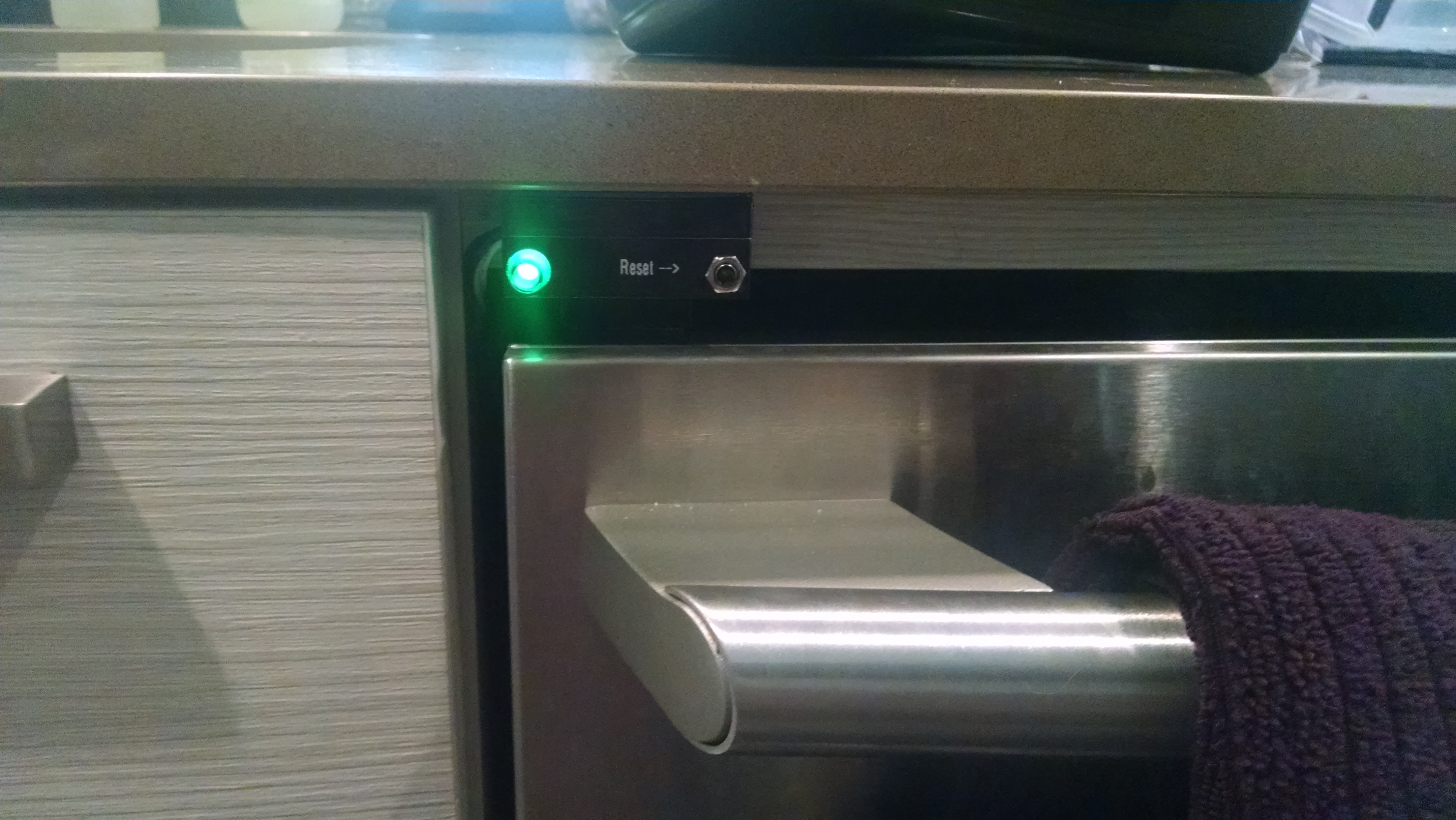

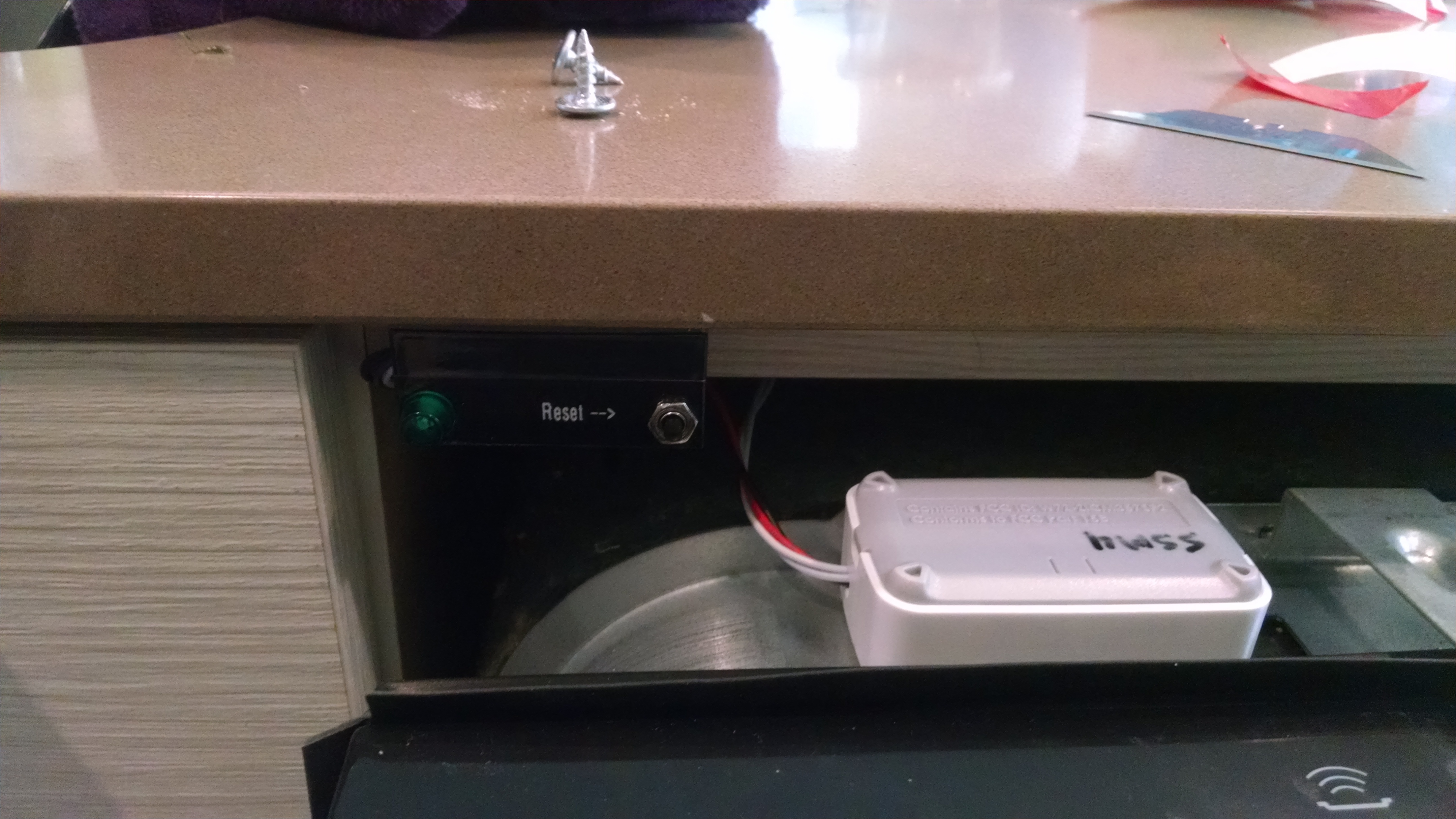

Per request, nothing special really.
DiswasherNanny: PEQ water sensor hacked into a contact sensor, powered from the 3V supply of an aeon micro, mounted on top of the dishwasher. App monitors temp change, uses aeon micro to drive small neon indicator, using Aeon’s device blinkers modes, slow flash when DW is active, steady light when cycle is done, super fast blink when door is opened to remind to put dishes away. Pushing button on panel resets indicator.

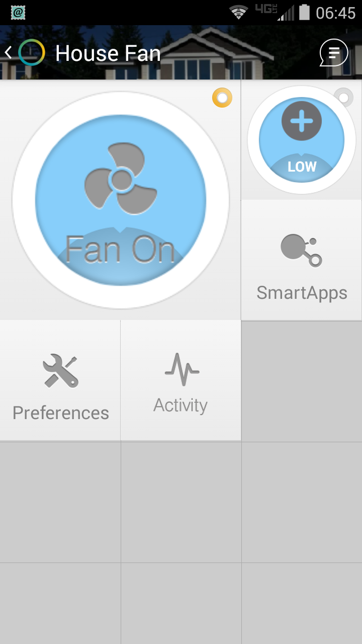

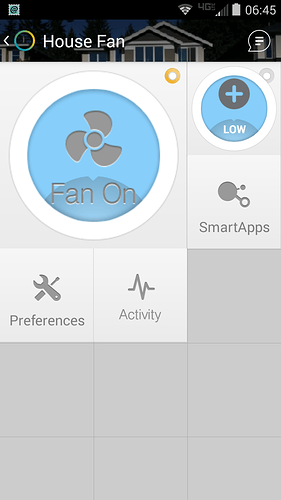

WholeHouse Fan: Aeon dual micro with relays, driver hacked to run two speed fan. Hacked ST multi, powered from 3v aeon micro, ST multi suspended in front of fan, contact used to indicate fan run status, xyz used to monitor fan load (cut speed back if not enough windows are open), app inputs from internal and external temp sensors and window contact sensors to activate fan and control speed.
I probably could have grabbed the fan load from the Aeon’s energy reporting, but it was flakey, and abusing the ST multi seemed like more fun…
