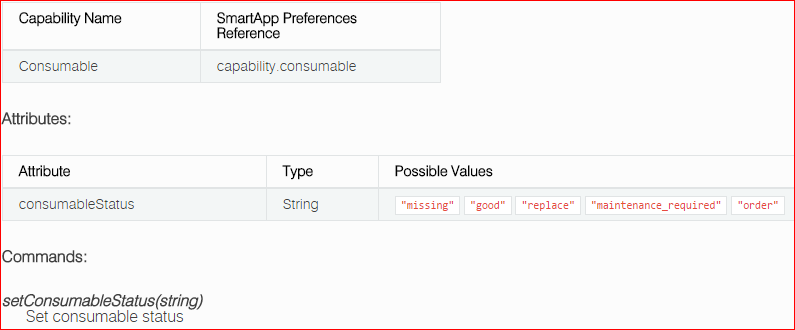

They are defined in the documentation, and as such, they show up in CoRE as well. Perhaps some virtual devices?
Capabilities are woefully under-documented.
Assume that “weird ones” were added to support some special partner vendors’ Devices (Samsung, etc.). Also do a search on the SmartThings Public GitHub in case there are any examples in open source.
BTW:
A “consumable” is likely something like copier toner, ink,paper, … or even coffee, water cooler water supply, pet feeder kibble supply,robot floor cleaner fluid, etc.
I was thinking the same, but didn’t find anything to indicate such. Thank you.
It looks like this could be used for a Smart Pantry or Fridge app.
That is correct, though these would have to be devices managed by such a SmartApp. You may be able to add “virtual” devices with that capability in the IDE. Go to “My Devices” and click on “New Device”. I couldn’t find one at a quick glance, but the list is long. Or you can write a DTH with that capability
You can find all capabilities here: http://docs.smartthings.com/en/latest/capabilities-reference.html
