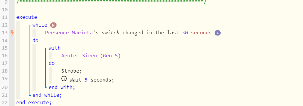

Hello, i swear webcore is driving me crazy, i’ve spent 4 hours already tried to do something fairly uncomplicated and i’ve debuged the piston and left now only the non working part of the code.
What i need the piston to do is simple, while a switch was turned on or off in the last 30 seconds, turn strobe ON on my siren every 5 secs, thats it

why on earth it doesnt trigger my siren`s strobe.
Switch got turned on in the last 30 secs which means state DID change yet logs show that state did not changed hence not turning on my siren.
I really can’t understand why, i’ve done much more complicated pistons but this just blows my mind. I tried with/without task cancellation policy to default and always run.
If i change the piston to “if switch changes” it works but like that i can’t make the while loop to work only on the 1st 30 sec after switch was changed.

The piston has fired because a switch event has been received. The status of the switch will have changed unless the developer has explicitly specified events will be propagated regardless.
You are querying if that switch changed state in the previous 30 seconds. The piston assumes that you don’t want to consider the event that just happened to cause the piston to run as if the value has changed you wouldn’t need to look back 30 seconds, and if it hasn’t it makes no difference.
