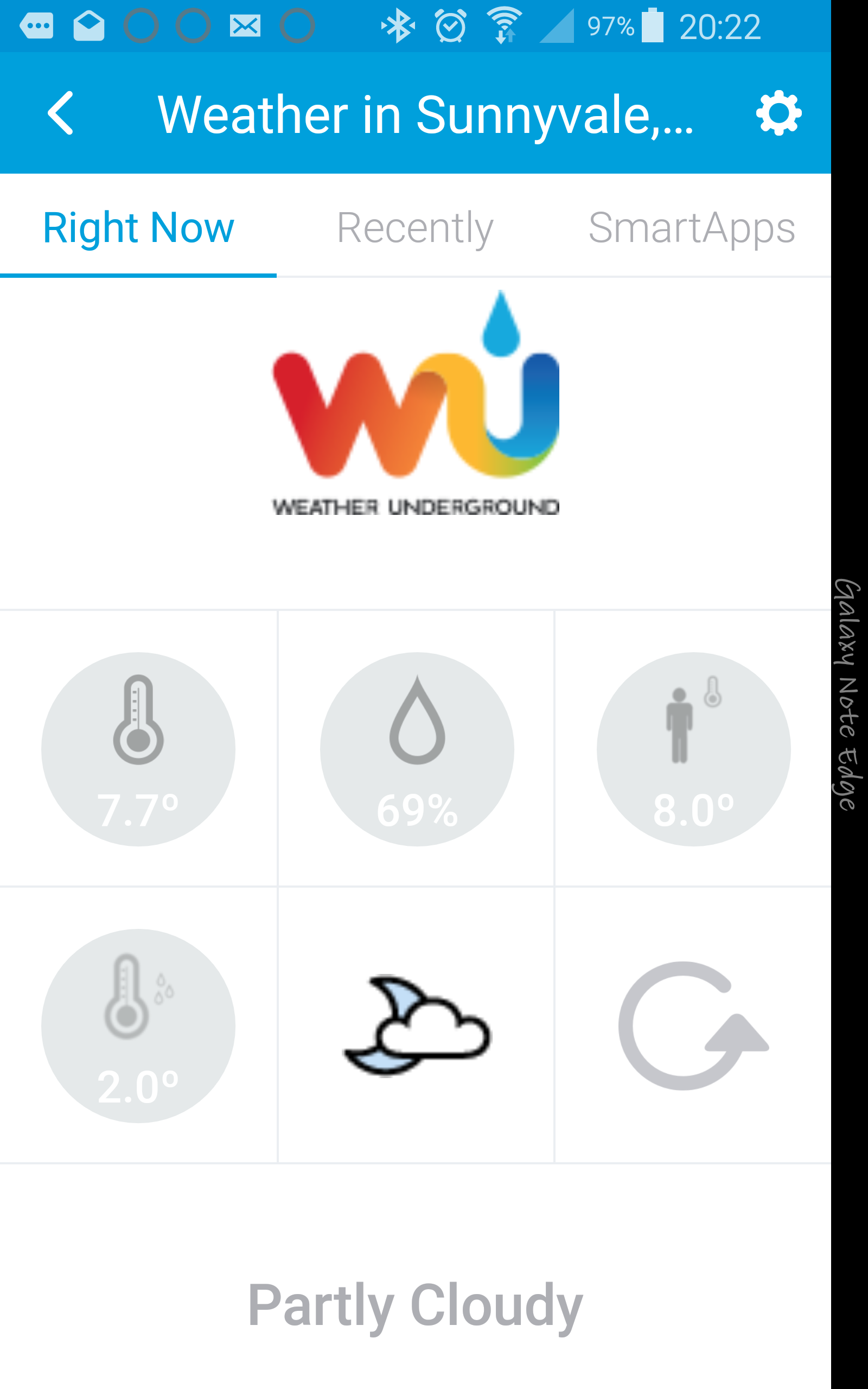

After the SmartApp parameter saving, the device handler is created under a composed name with the “Weather in city,state”.
This device details allows to see the values provided by Weather Underground:
-Temperature
-Real feel
-Dew point
-Relative Humidity
-Weather condition (icon and description)
