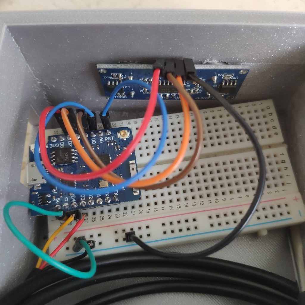

I’ll post a picture of my setup later, I use it to check the water level of my balancing tank.
Many thanks - look forward to seeing the picture.
Basically it’s a D1 mini Pro (can use nodemcu as well), and a ultrasonic sensor (this set not water proof but I hanging it some height from water), in a 3D printed box. I added temperature sensor for another purpose
