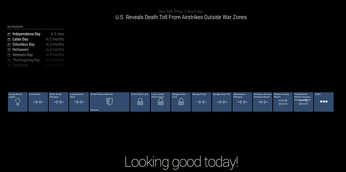

Last weekend I wrote an iFrame plugin that you can use smartTiles to display. Its nothing special and it’s my fall back solution.

Here is a preview of how the iframe looks running SmartTiles. You can resize it and move it to any location on the screen.
Sweet! Would webcam streams show up ok?

Whatever SmartTiles can show the iFrame will be able to show it.
