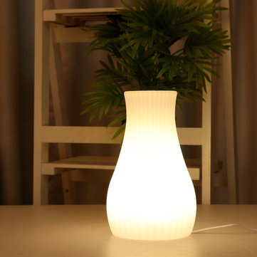

I am aware of one Chinese company which makes nightlights intended for weddings and things like that that say they have a battery life of about 12 hours. That would mean you have to plug it back in every morning. But they do work with Alexa, so you could get partial integration that way through Alexa routines. There’s no direct SmartThings integration. I don’t know if that would meet your requirements or not.
Probably the least expensive reputable retailer for these is Banggood. (Make sure you understand their returns policy before ordering.)
If you prefer to buy it through Amazon, you can, but it will be more expensive.

Thanks JD. The Banggood link comes closest to what I’m looking for, though with longer run times. I’m looking for OEMs of the components to create my own accent lamps. The bulb is the component I’m having the most difficulty with. I’ve looked at quite a few Chinese mfrs of LED bulbs and contacted a couple, with no luck. As I mentioned, maybe I’m not asking the right questions.

I doubt if you’ll find longer run times because the light itself uses a lot of charge. Even a dumb battery operated light rarely lasts longer than 12 hours, and when you add in the requirements of operating the radio, the one I linked to is the best I’ve seen.
