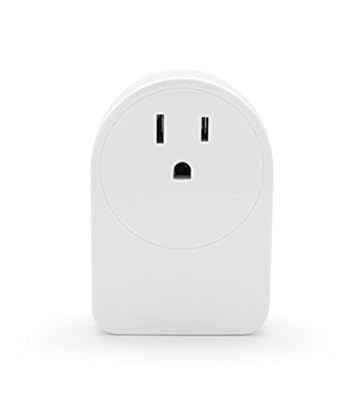

I am looking to somehow dim the under cabinet dimmer lights, unfortunately all the plugin dimmers that I’m seeing do not have ground on zwave outlet, just pass through, and led lights plug that I have had the ground plug, any ideas or solutions would be very much appreciated.

no kidding? I never noticed that. What about Remotec ZDS-110na? That is switchable to dimmer or switch and has ground plug.
