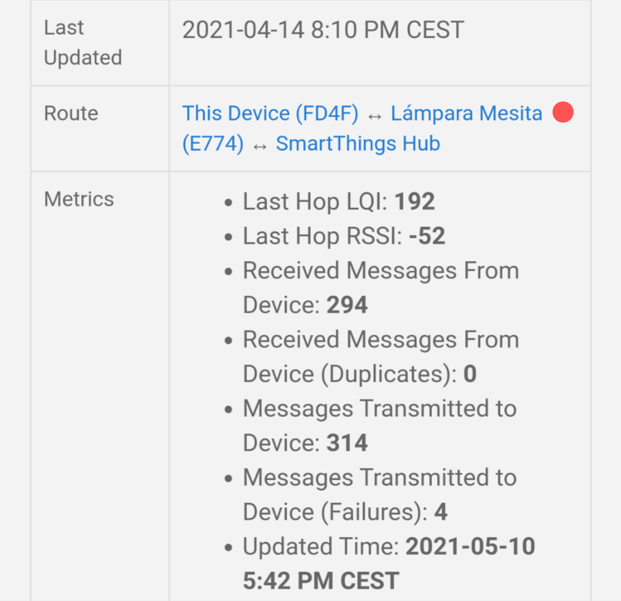

You can look at IDE for sensor connection metrics and see how many failed messages out of the total messages sent to the sensor you have.
You can also see through which repeater devices it connects or if it does so directly with the hub.
Inside the refrigerator the radio frequency signals going in and out are quite attenuated.
With these data, you can start to analyze and look for other causes

It remains to be seen if sensor connects directly to the hub or through repeaters. That’s right above “Route”
A Repeater can be a zigbee device, in this case, as socket, light bulb, light switch. Normally devices that are powered from the electrical network.
Don’t you have any installed?
you can see the path in IDE, like here
