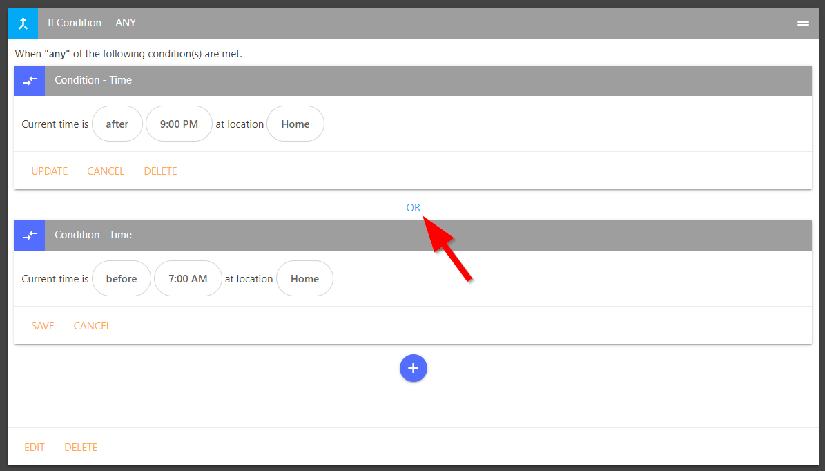

@DarthBob, nice rules. Just wanted to make sure you used “OR” condition logic for the 9:00PM - 7:00AM, since it is considered as the next day after the midnight.
Having the rule to call another rule is a cool idea, and there’s already an open feature request in SharpTools community for it. So you may want to vote your interests there.
I must admit that I’ve only tested it in the evening, however, never after midnight. I may have to test this tomorrow morning when I get up to let the dog out.

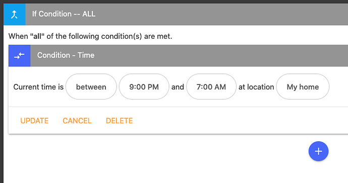

Tested it early this morning, when I got up to let the dog out. The between condition functioned as expected: It waited 15 min., then closed the garage door and notified me.
