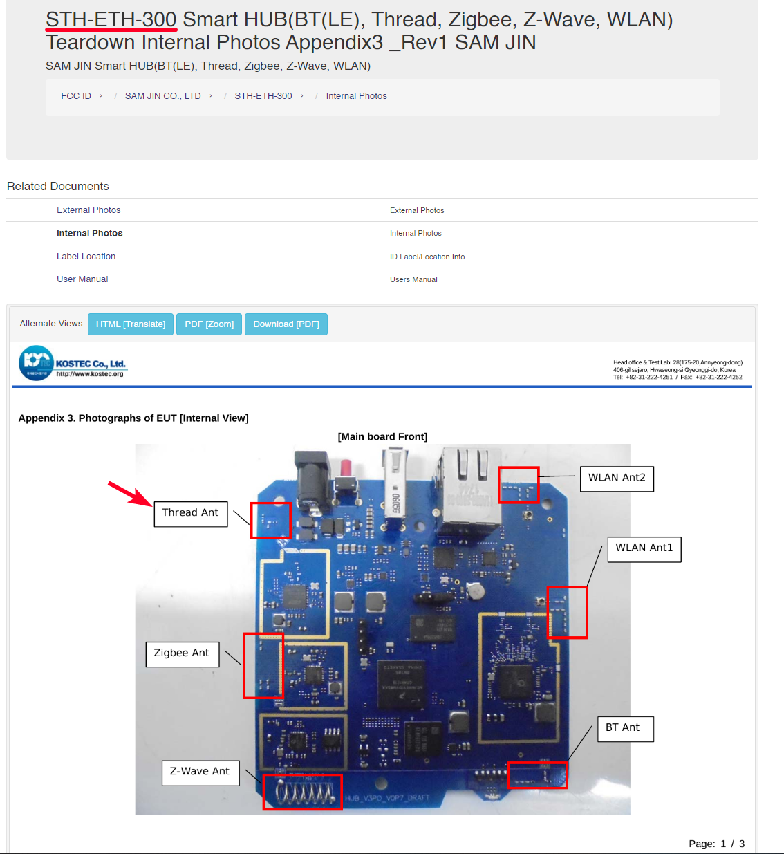

Many moons ago, @JDRoberts noted that the official FCC certification for the Samsung V3 hub does include a “Thread Ant[enna]”, but if there’s any hope for that ever functioning is anyone’s guess.
