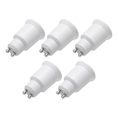

Get some of these too.
If you live in Europe (220v) then these fit exactly what you are looking for: http://www.amazon.de/dp/B00JDJC13S. Unfortunately, it doesn’t look like they are available in US versions.

So right now, it looks like your choices are Hue RGBW, LIGHTIFY White only, or an adapter, maybe with a Hue white only bulb.
