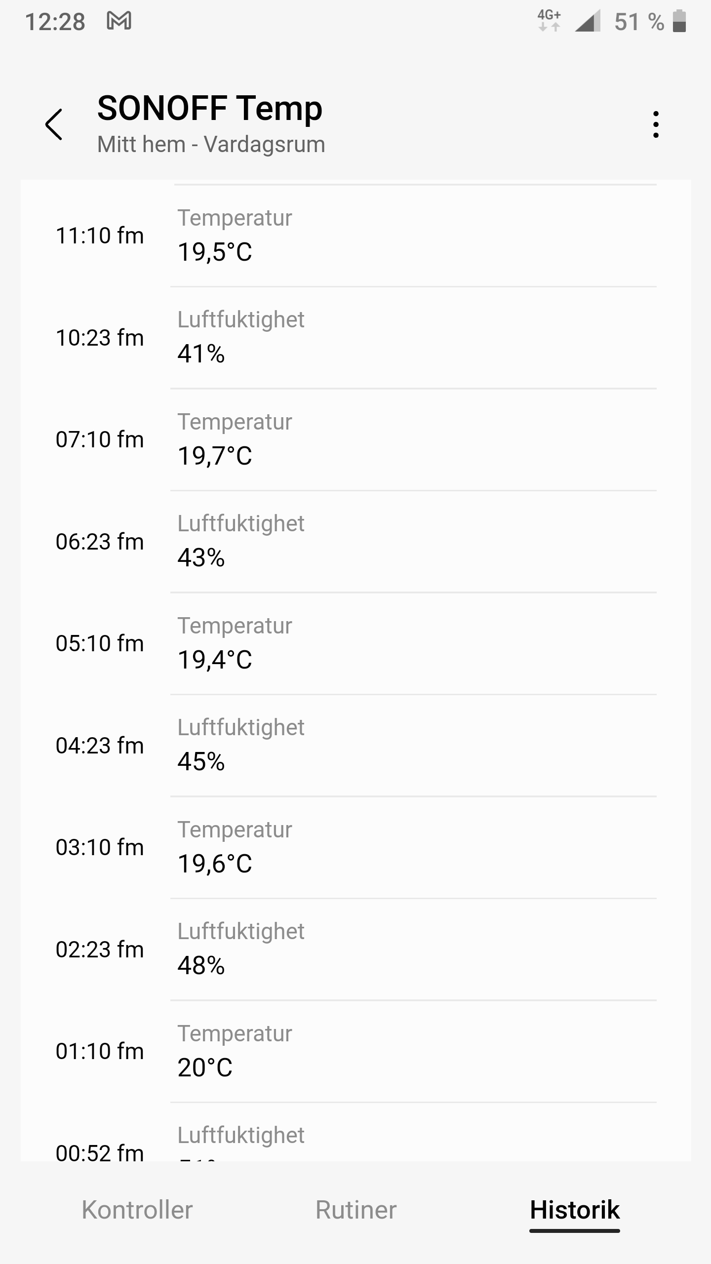

I have SONOFF, Aqara and Aeotec temp sensor. Same problem with all of them. I change settings to update more often but then i doesânt do it anyway. I used your driver on SONOFF sensor and change settings a couple of days ago but nothing really changes. It updates temp Every two hours even though I set it to five minutes.
What could be the problem?
The problem is often that devices with battery power often sleep between reporting intervals and the configuration change is not executed on the device.
You must also take into account:
If the temperature does not change, no event will be sent.
That is, if you see that an event is sent in two hours, but the change has been 0.1Âș, then that is correct.
this is sonoff configured with Reportable change = 0.1Âș and Max interval Report = 5 minutes

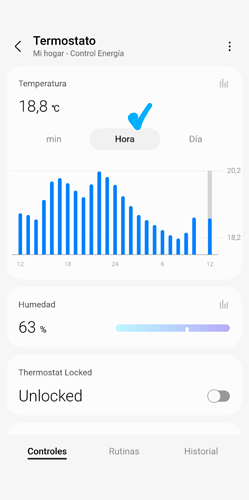

If you want to ensure that you are informed of any temperature change, you have to set the Reportable Change to 0.1Âș or whatever you want.
This will report any temperature change >= 0.1ÂșC regardless of whether the maximum interval is met.

I left the CLI on and it there is activities quite often, at least every 10 minutes but when i check history on smartthings it is as before. Every two hours.
Dont really know what to do now. A little wierd that the problem is the same on my other temperature sensor as well.
