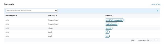

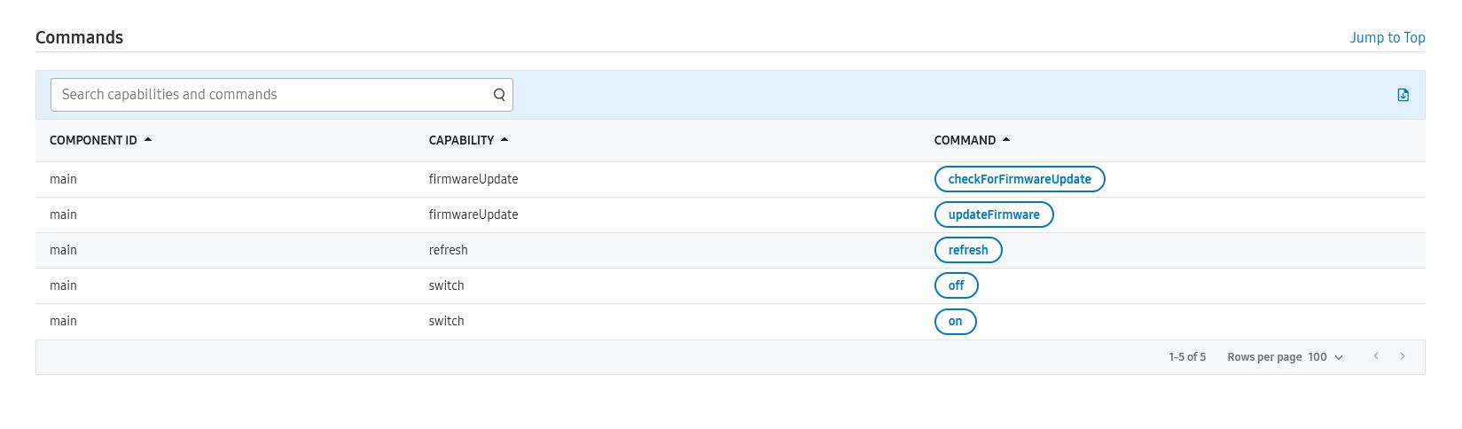

No specific fingerprints for Tapo devices in the matter-switch driver, so you may only get generic support such as on/off and dimmable depending on the deviceTypes provided by the device. For example, here are the deviceTypes needed for an on/off, dimmable, color changing device:
- id: "matter/colorTemperature/light/2"
deviceLabel: Matter Color Temperature Light
deviceTypes:
- id: 0x0100 # OnOff Light
- id: 0x0101 # Dimmable Light
- id: 0x010C # Color Temperature Light
deviceProfileName: light-level-colorTemperature
And you don’t necessarily need to do the cloud->cloud integration if you are going to commission the device for Matter.
