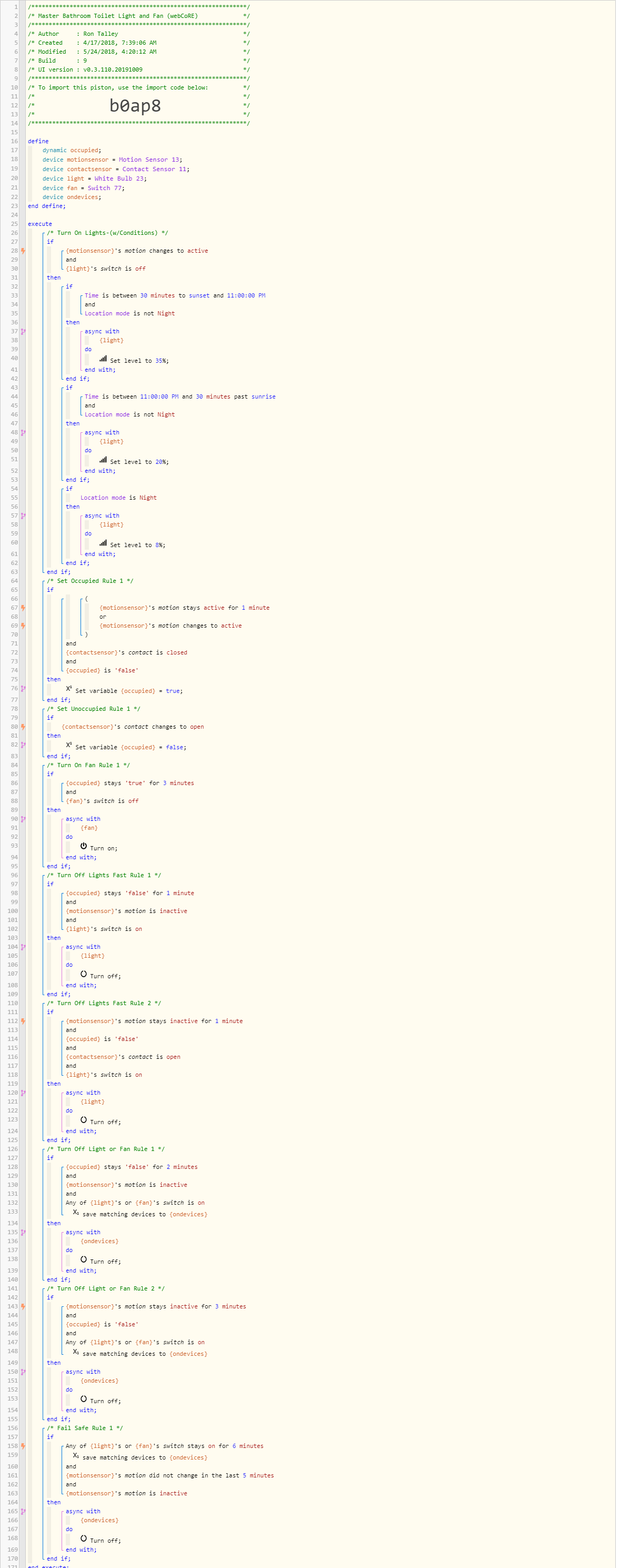

I use a regular GE Switch like the one @JDRoberts posted. I then use a webCoRE Piston to turn on/off the fan based on various conditions. You are welcome to import and edit to your likings.
