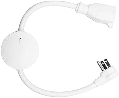

I would use an energy monitoring device. Like this:
You would wire the actual fan power into this first. This has energy monitoring in ST.
