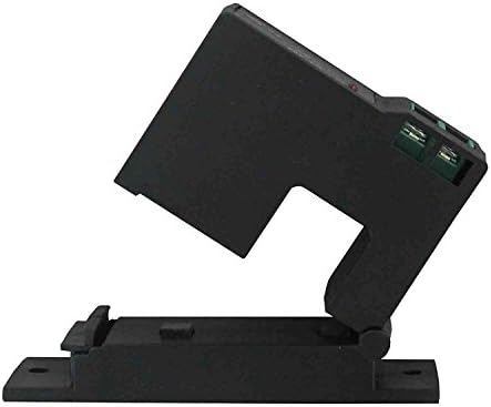

OK just did the climb, and it was a nightmare. The unit is rated a 4.3 Amp at 120 volts. So that 4.3 amp is the starting amperage, not the running amperage. So a guess a current sensing relay of 3-4 amps would do. Now to find a small unit. And see which contact sensor has terminals to wire the relay to. Is there one you suggest?
Cheapest I know of are the EcoLink ones. Think around $25 for Z-wave plus. For the current sensing relay yes most are adjustable. Something like this would work:
Allan I think I will decide soon, but this is the one that I think will work easier as it is a pass through no large clamp. This will fit inside a standard deep 1900 box. Let me know what you think.
Current Sensing Relay
Yeah that would work fine if you don’t mind having to rewire.
Minor rewiring job and it will be inside the box as the box installed is very deep. Actually way too deep. The clamp on would work great usually the clamps are large. But since no measurements are shown I am not sure.
