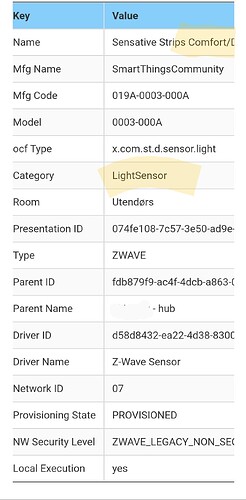

At the moment, it looks like this
  1. in location 1, on a V2 hub, using a “moisture icon”:
  2. in location 2, on a V3 hub, using an “illuminance” icon:
So, as mentioned above, not exactly consistent between product instances, nor, I would say, according to product description.
Does the page not show a field called “Model”? I don’t see it in your screenshots.
In SmartThings, the device’s “fingerprint” is the combination of the exact manufacturer code, and the exact model.
If those two are different, it might explain why they had different profiles in the driver. :thinking:
The device on the v2 hub is using the water-illuminance-temperature profile and the one on the v3 is using the illuminance-temperature profile. While the manufacturer’s code is the same on both devices, I’d be curious what the model name/number is. There is clearly a difference between the two devices that causes a different profile to be selected and is likely the reason for the different icon being selected. Also notice that the device name for the one on the v2 is the profile name vs the one on the v3 being a more specific device name.
They are both having model number 0003-000A, curiously enough…
Identical model numbers. And assigned to different device names, the v3 name corresponding well with the product (commercial) name.
