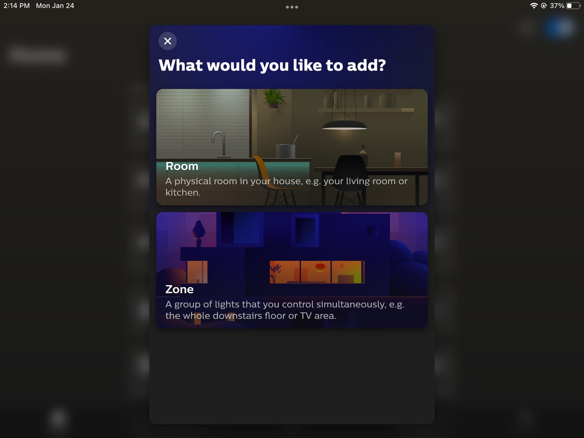

Doesn’t work because one of the main issues with Hue and third-party integrations is that they don’t have a unique group or scene ID. It’s all context sensitive based on the room that you’re in. This is the primary reason that hue scenes are not exposed to most other platforms, not even HomeKit. (This is technically called a “waterfall naming convention“ if anybody cares. )
Alexa did it by attaching the hue room name to the scene name, but many platforms don’t allow you to have a scene name that is that long.
They added “zones” a year or two ago specifically to address this integration issue, but most people don’t use those.
So you may want to visit the hue developer community before getting too deep into all of this stuff, the architecture is unique.
It also doesn’t give you access to Hue Rooms or Hue Zones. When I refer the Hue Lighting Groups, this is what I mean. Each Hue Room/Zone gets a unique ID that you can use to set a scene on it. Each scene is also given a unique ID and is assigned to a room or zone. This is what Alexa imported. I want to import both Hue Groups and Hue Scenes, but control things through the Group. I can do all of this via REST. This Web Requestor will be capable once PUT is added. Once it is available, I’d be happy to do a writeup on integrating Hue Room/Zone control using the Web Requestor. It makes a good stop gap until a better driver is available
