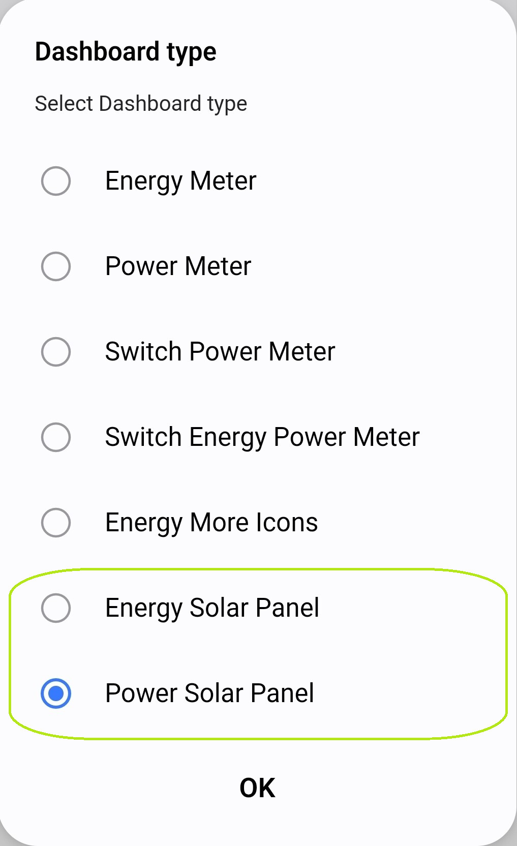

I added the solar panel icon to the energy and power devices.
Driver Id 0f58f526-d7cd-48f2-837a-610a4c164939
Name Virtual Energy Power Switch Device Tx
Version 2026-02-08T12:38:54.50257733
I got the idea for this addition from @Patrick_Duarte Solar Inverter driver. Thanks
