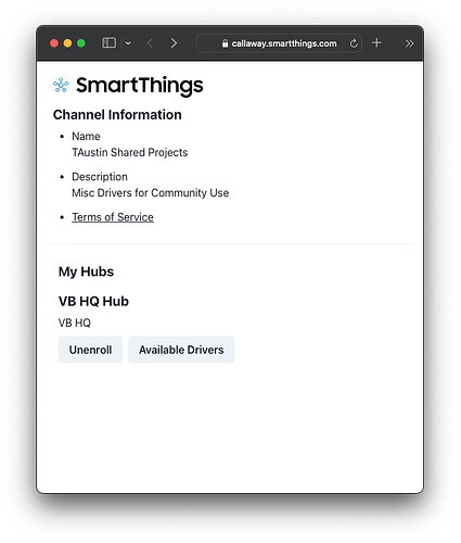

Having trouble installing the vEdge creator. I’ve followed the instructions from @TAustin at the beginning of this thread. Logged into my Samsung account, and enrolled my hub. It shows that it’s installed if I look at the channel link. I understand it can take some time, but that was done on Friday, so it’s been almost 48 hours.
However, when I use the SmartThings app to Add Device / Scan for nearby devices, it doesn’t find any new devices, and I do not have a “vEdge Creator V2.94” device anywhere, nor do I have any new/unrecognized devices in any room. I’m running SmartThings v1.7.05 on an iPhone 12 Pro running iOS 16.6 build 20G75
I rebooted my hub as one troubleshooting step, but I’m not sure what else to try.
Any thoughts? I need virtual switches. I’d really like them to be Edge so they’re local to the hub, and it would be nice to have the functionality where Alexa can trigger routines based on their status. This vEdge Creator seems to be the recommended approach, but I can’t figure out why I can’t add the “vEdge Creator V2.94” device.
I had a similar issue and had to turn on “Ask to add new devices” in Smartthings settings

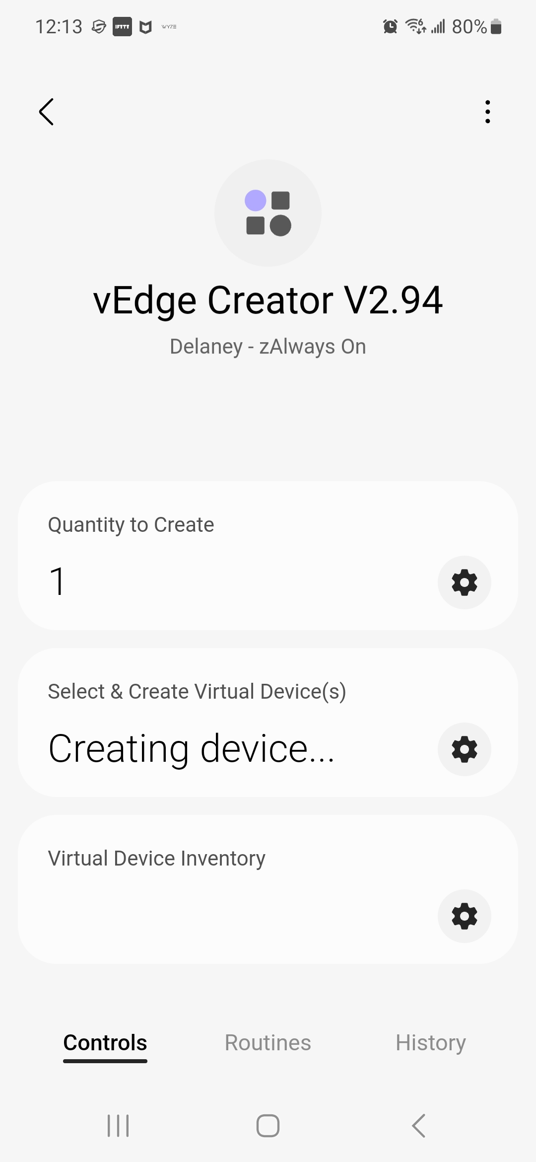

Sorry to be a pest @TAustin … maybe this sheds some light to the issue I reported yesterday, but I am stick with this message when I try to create another Alexa Switch …
I ran into the same issue as tpkps. The create a device message would just stay. Ended up backing out of the screen and start the process over. Device created successfully.
I removed and reinstalled creator 2.94 … same issue as above … tried another create on top of it and it created 1 alexa switch immediately. So, I tried to toggle the separate contact off on a number of alexa switches without one. Sometimes turning the switch on and off in between. I seemed to intermittently get a couple of separate contacts to add, but not all of them reliably … can’t figure out if it’s random (i think it is) or if there is a sequence that i am doing which allows the creation of the separate contact
I seem to have figured something out … it appears that if I wait long enough on the screen where the separate contact is toggled, the contact gets created. I can take some time. I think that I impatiently left that screen when it didn’t work. In those cases, the toggle stays on but the contact never gets created. Not sure if this makes sense, but it appears to be what’s happening!
