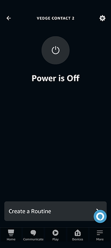

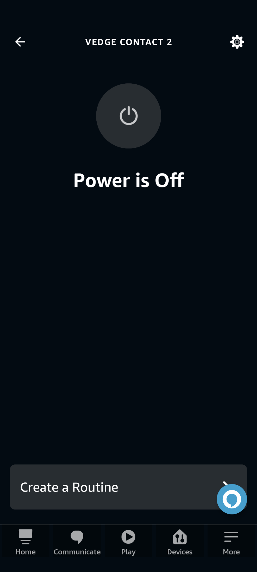

When you look at your virtual house sensor in Alexa, do you see “On” or “Off”, or do you see “‘Open” or “Closed.” In my case, it’s the former.
In Alexa, the virtual contact sensor should show as Open or Closed. In ST, it will show On or Off.
I turn it on in Alexa and it shows “open” in ST”. I turn it “closed” in ST and it turns off in Alexa.
Then somehow I’ve got BOTH of them backwards! I have no idea how.
Nor how to fix it.

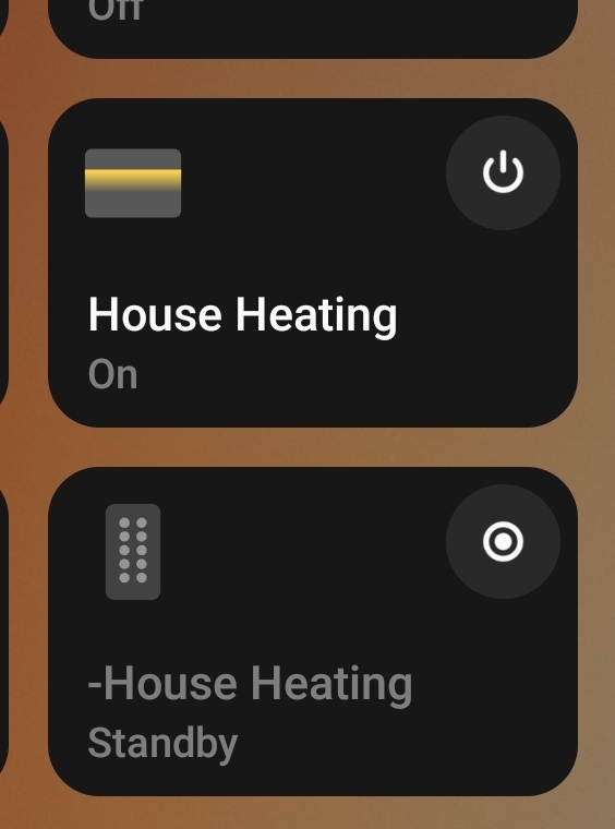

When the momentary switch is set as a simple toggle, can we have the device, in the room, show the current state instead of it being momentary? In this screenshot, both devices are in, but the momentary is showing off.
I could possibly add an option to show the switch state & control on the dashboard instead of the momentary button, which is what you are seeing.

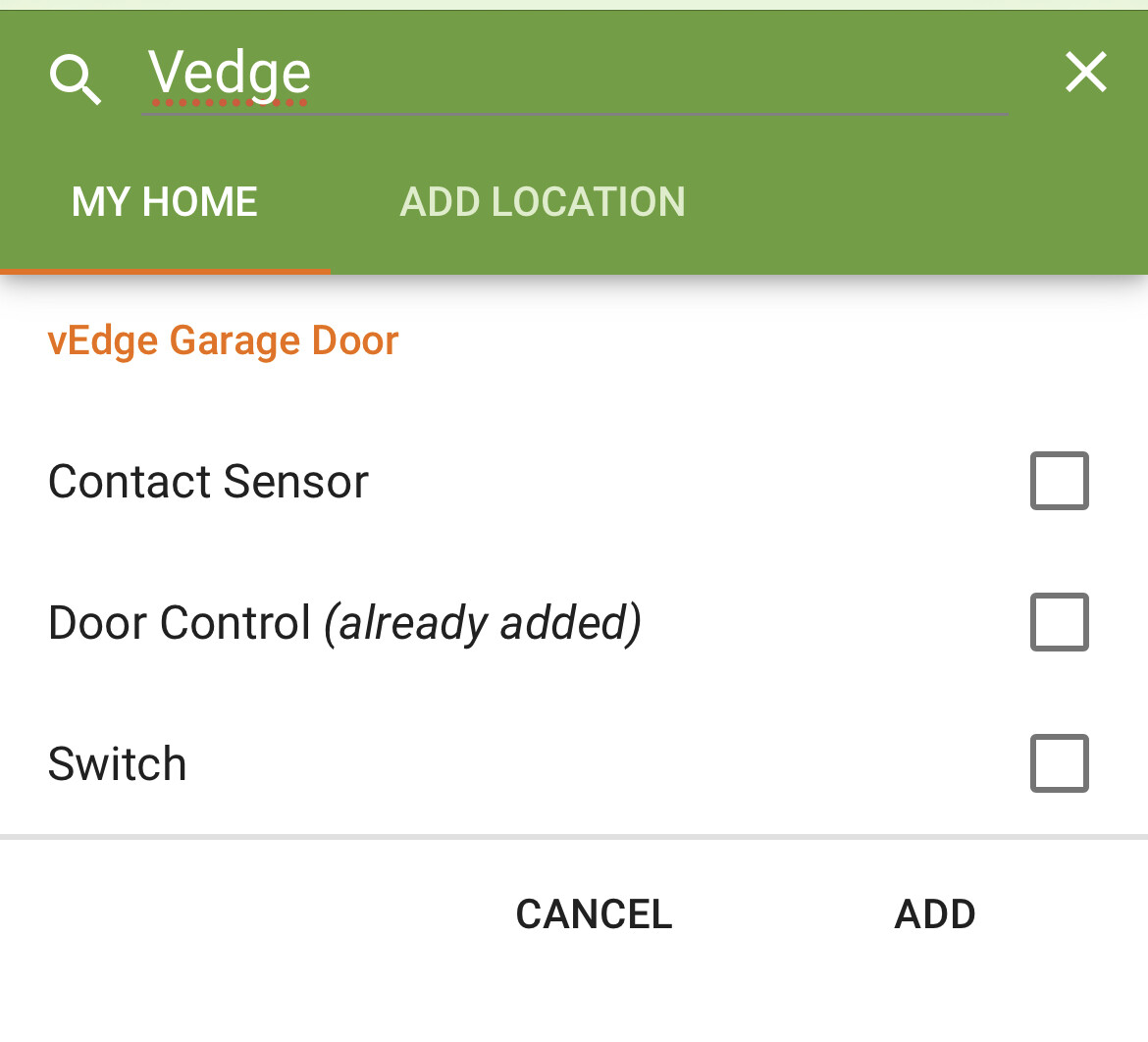

@TAustin would you happen to know why the garage door isn’t working as expected in ActionTiles? I have three routines setup for the virtual garage door. One to control the door, one to show open state, and one to show closed state. All seems to be working in ST. In ActionTiles, however, I can’t control the garage door (the states do show correctly) when the tile is pressed. I’m hoping to have one tile that both controls the door and shows the state (I have desynced in the ST settings).
