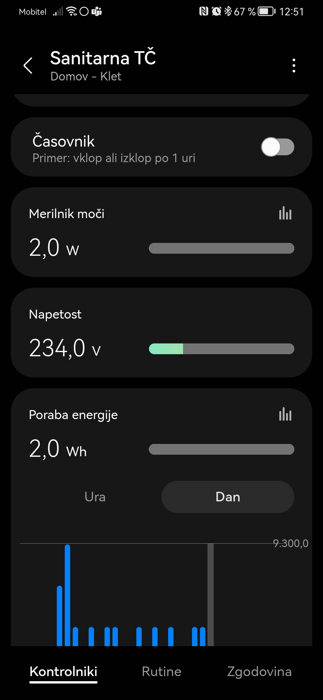

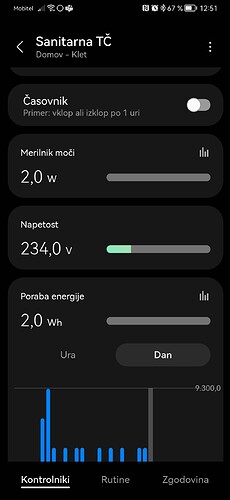

Sonoff POW still does not show the right values in the application (energy total). It often happens that the values are not refreshed in the application.
Now the app shows that energy total and active power are the same???

Can you check whether the latest version 2022.10.6 is able to show the correct energy values?

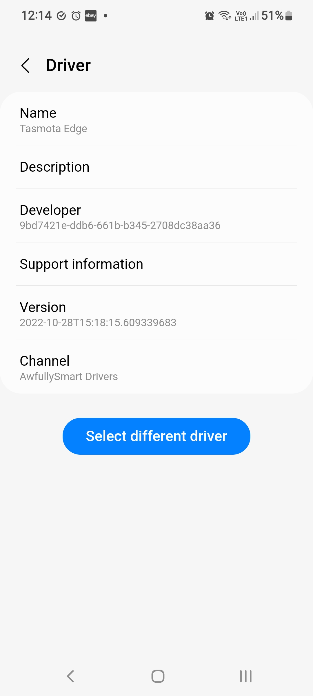

Is this the latest driver?

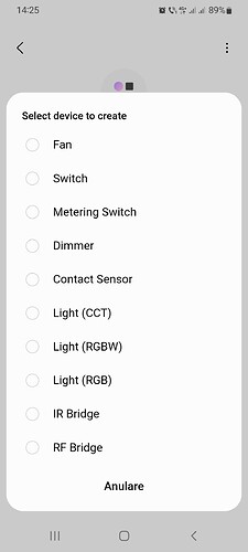

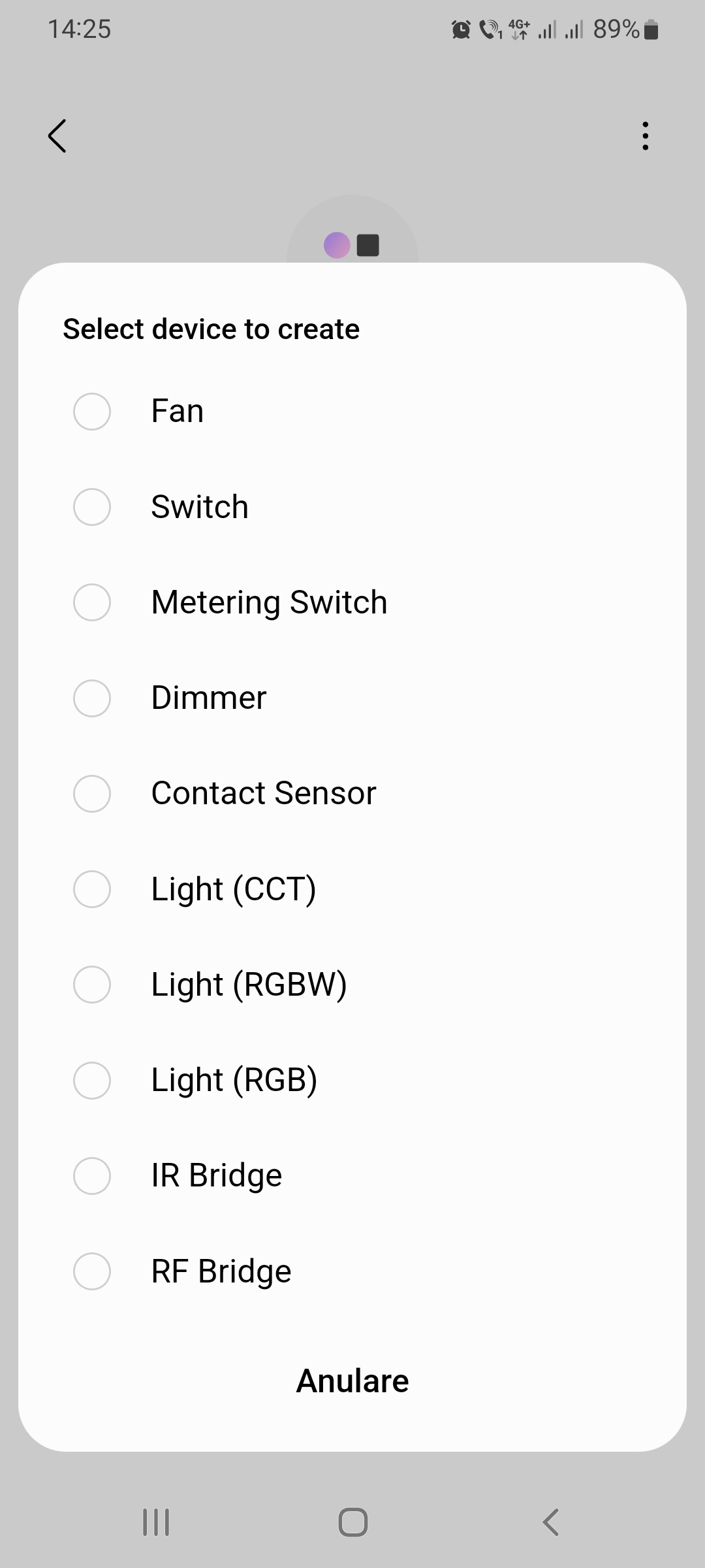

I don’t have the option for motion sensors.
your better of looking in the app as it gives you the version not just the id .
Yes, my app shows exactly the same information as yours. However, when I try to create a new device I do not see an option for motion sensors.
