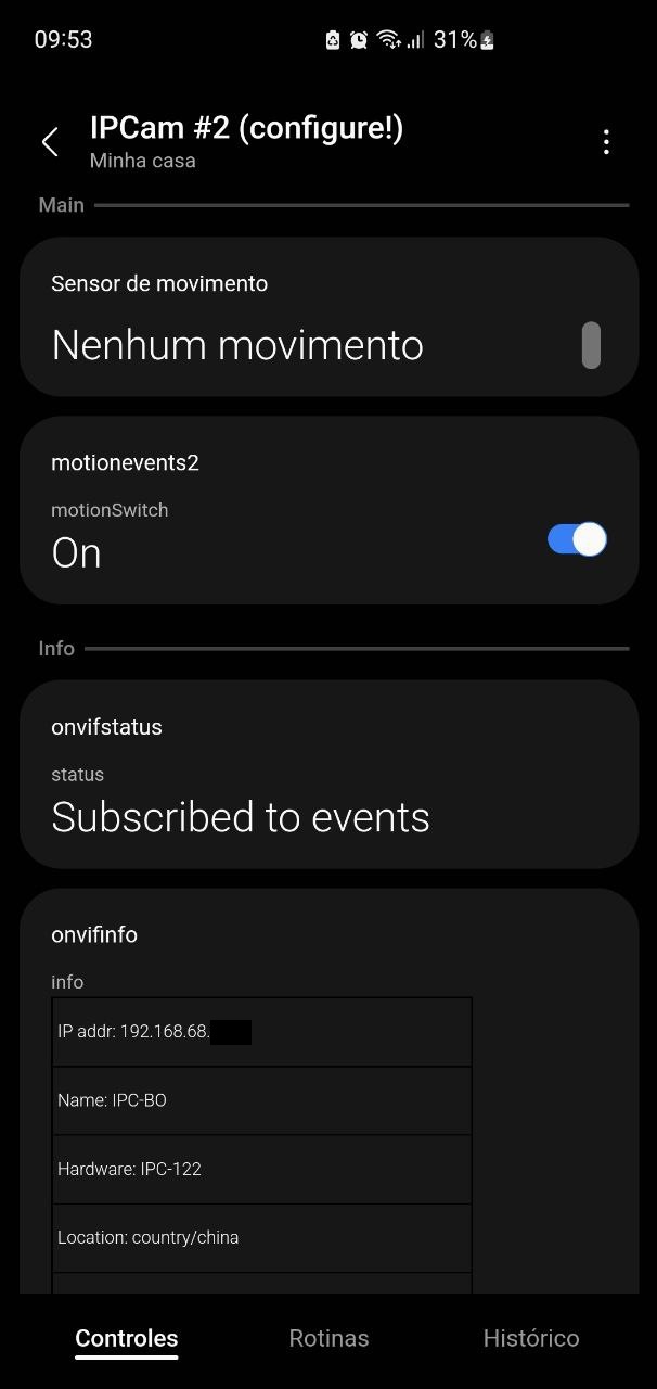

Hi, can you tell me how you managed to display the video in the smartthings app? I only got motion detection (I’ve even tested it as a routine trigger and it worked), but the image doesn’t appear.
Mine is an RLC 410W too.
I send below the information that appears in the smartthings app
Are there any special characters in your userid or password for the cameras, or anything unusual about them? We have found that in some cases this can cause problems with the authentication during the streaming request to the camera.
I’m sorry you’re not having success. Someone has definitely reported that they had the 410W working OK. The only other thing I can think of is to make sure that you don’t have some config option that needs to be turned on for ONVIF support.
If you can, you could download the CLI and run some log outputs so I can see if anything is going wrong. But it looks to me like all the initialization completed OK.
