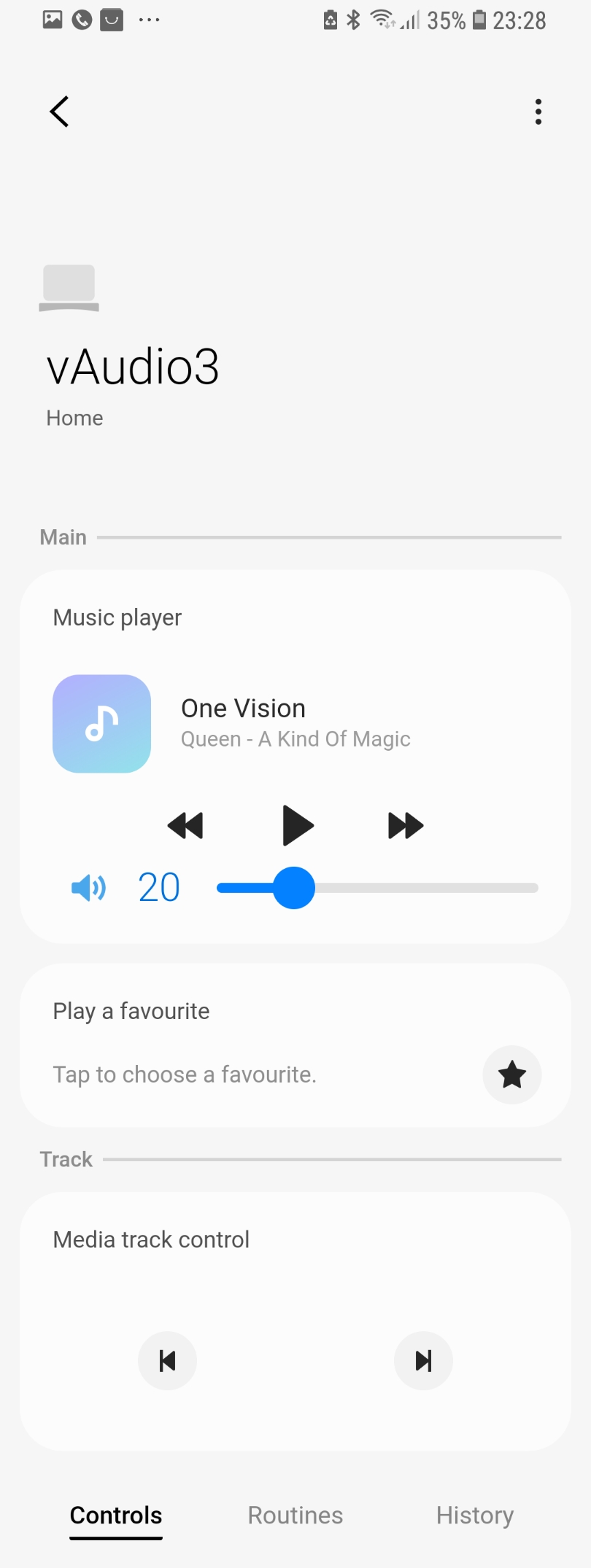

I made more tests and I can see all the buttons, could you share how the device UI looks on your side, please?

I was experimenting with audioTrackData.
It seems that UI would try to put media related capabilities inside audioTrackData view, if it exists in the component.
However, audioTrackData’s view is probably unable to dynamically expand, so whatever does not fit into its view, is just not shown in UI.
I found a way to workaround this by adding ‘track’ component
