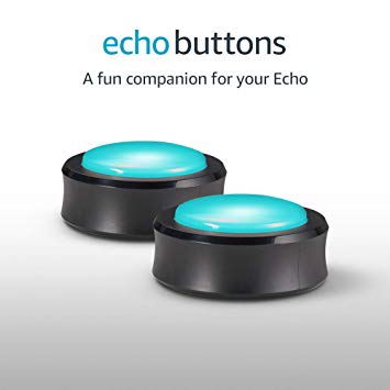

Love this idea, hadn’t thought of it, we have toilet bells on the back of the front door that we taught him to ring when he needed to go out rather than bark or scratch the door :). these might just work…
