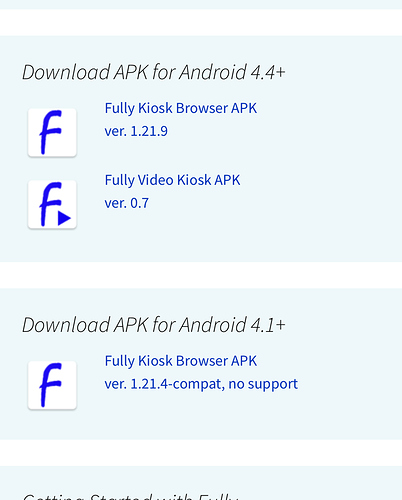

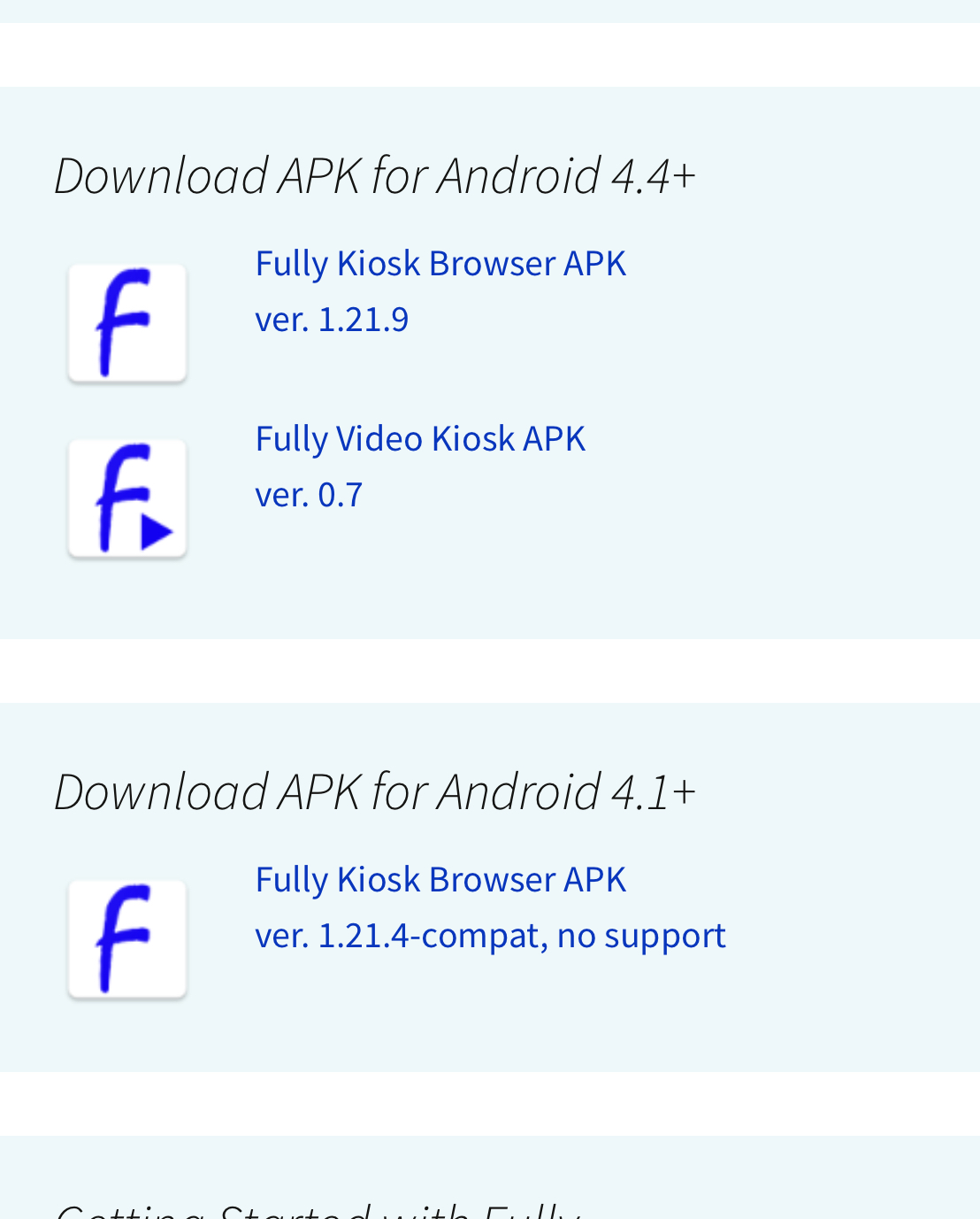

I saw in this link that we were able to install fully kiosk on android 4.3. I downloaded the link on the Wink Relay but he did not want to open. Does someone have an idea.
http://www.ozerov.de/fully-kiosk-browser/#installation

Anyone have the compatible version of the fully browser? I haven’t been able to find one that works with the wink relay
