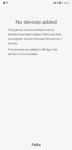

during testing I used two different Webhooks to try to investigate the problem,
the first on our main platform and the second on an another platform,
the results are Grade A and Grade B respectively.
For information, Keycloak, which implements the OAuth2 scheme, use self-signed certs;
could this be the problem?
