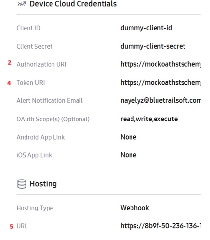

For example, considering the picture above, my integration calls this URL when I select it in the app:
https://mockoathstschem.glitch.me/oauth/authorize?client_id=dummy-client-id&redirect_uri=https://c2c-us.smartthings.com/oauth/callback&response_type=code&state=...&scope=read%2Cwrite%2Cexecute
Once step 4 is completed, SmartThings will have an Access Token to authorize its requests with your server.
