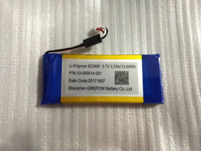

SO. Now that I have gone and got an entirely new hub, i now have the backup battery information to share with everyone. And hopefully the SmartThings support will fix their missing information.
LiPolymer 823990 3.7V 3.7Ah/13.69Wh
P/N:10-000014-001
Date Code:20171507
Shenzhen GREPOW Battery Co.,Ltd
QR Code Data:
1)P/N:10-000014-001 2)Date Code:20171507 3)Manufacturer:Shenzhen GREPOW Battery Co.,Ltd
Obviously, the date code doesn’t matter, but I put it there for reference, and to show that a brand new 2019 hub has a freaking 2017 battery. That is complete junk. No wonder so many people say this battery lasts only (15) minutes instead of the supposed (4) hours that SmartThings claims.
Note: Contrary to popular belief, that ferrite core on the battery cable is important.
Has anyone successfully sourced a replacement battery? If so, where? I will contact the manufacturer next week, but I was hoping to locate one from an online retailer.

Maybe look for a 2GIG GC3 backup battery? The ADT hub is nearly identical to a GC3 panel.
Here’s one for $29: https://www.all2gig.com/index.php?route=product/product&product_id=18443
Many more retailers exist. This panel is used by several alarm companies so replacement batteries should be around for a while.
Reid - That’s the one! Thanks!
