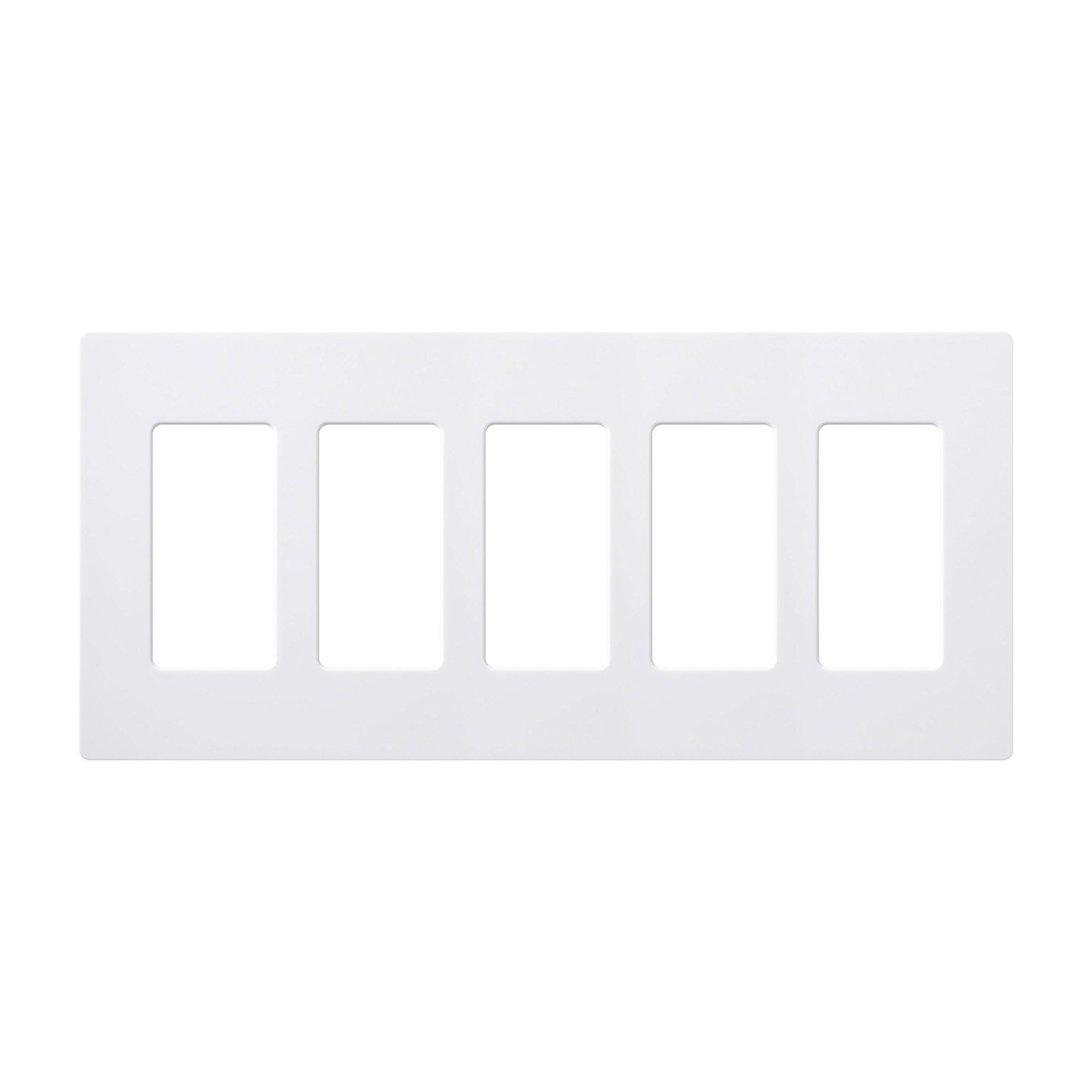

how would I install a smart switch in the scenarios in the picture linked aka that has 5 switched together

this looks like a 5 gang setup, US standard I hope. I’m not sure the exact question, but maybe you’ve never seen inside. Inside, it should be 5 individual switches. So if you pop the cover off, it will look crowded, but you can work on replacing one while largely ignoring the others.
I’m not sure what you mean by “switched together”. My assumption is that a 5 gang with 5 switches leads to 5 independent lights/devices. They reside in the same gang box but otherwise have nothing to do with each other, right?

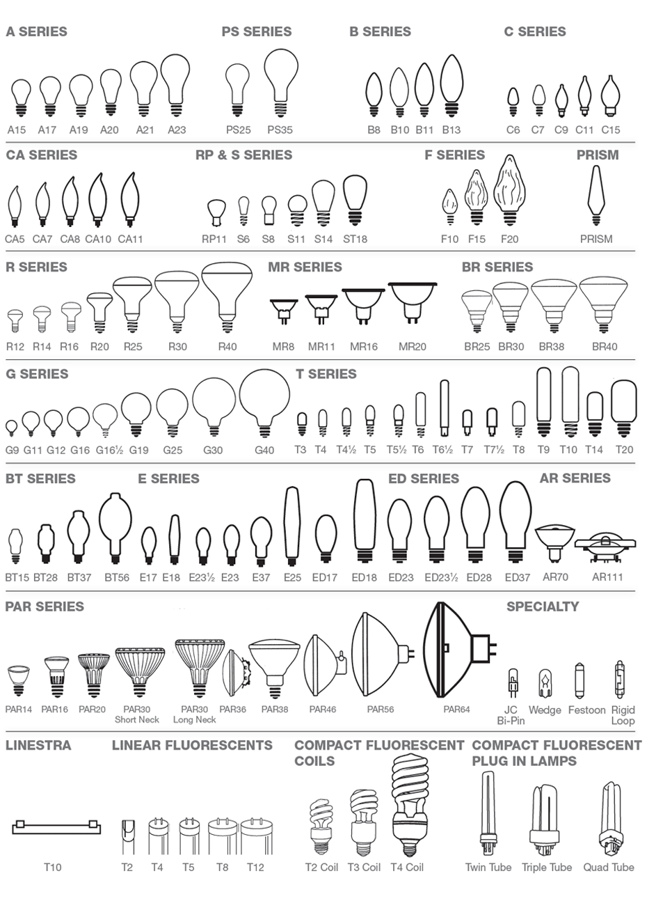

Inside the house a lot of them are standard a19.
But we have a lot of PAR20 and possibly cri80+
The girl hates those lights and plan to change them at some points but no idea when. So for now we are stuck with those dumb lights.
But if we do change them I’m not sure philips hue does par20 and cri80+.

“CRI” is a completely different kind of measurement. It refers to the “color rendering index“, or how close the light is to natural light. The higher the number, the closer the color is to natural light. Unfortunately, it’s not a very accurate measurement, so most light bulb manufacturers don’t even print this value on their boxes.
As far as The situation where you have five switches next to each other and only one of them will control a smart bulb, I already gave you that answer in my post above.
There are two different kinds of devices you can use for this situation.
The Sylvania dimmer switch is a smart switch cover. It uses batteries. It fits right over the top of the existing switch. It works well with smartthings. The only problem is the look as it is a very different looking switch than the ones it will be next to. If smartthings is not working, you can just lift up the device and use the original switch.
The other option is to use a switch which looks just like a regular rocker switch. It gets wired into the wall just like a regular switch. But it does not turn the current on and off to the bulb. Instead, it sends a message to the hub which then sends a message to the bulb. So as long as smartthings is working, switch will work. But if smartthings is not working, the switch cannot talk to the bulb.
Kelvin scale to describes light bulb color. Like 4k Kelvin is my preferred color lights. I hate yellowy 2800. Looks like smoker lived there.5k is a little too clinical and shadowy imo.
I always buy switches if there’s more than one light or if a switch is there already, otherwise bulbs. If there’s a switch there already, you’ll have to bypass it or something anyway because people will turn off the switch!
CRI is color accuracy of viewed objects. Kelvin is the color of the light.

I quoted that bit because I think it’s a source of confusion. I don’t have pics handy like jdroberts does. but I suspect our OP isn’t familiar with wiring.
in the US, switches are generally the same size and are mounted in a gangbox which is a plastic box mounted to a stud in the wall with wiring run into it for the switch. a 1 gang box holds 1 switch. a 5 gang box holds 5 switches. If you buy a smart switch, the body is bulkier than a dumb switch, but it fits in the space of 1 switch.
I won’t say you’ll have no trouble fitting a smart switch amidst the 4 dumb switches in that 5 gang box, but it CAN fit. The biggest problem is bending wires out of the way without uncoupling them.
