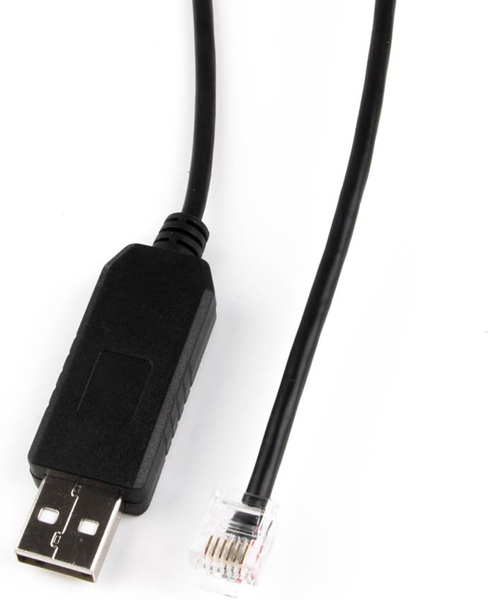

Note: Apparently in some countries e.g. the Netherlands a smart meter has a type of serial port which can be linked to via a cable for local read only access.
So, in the UK it is not possible to link directly via Zigbee to the smart meter, I do not know for sure but I suspect UK smart meters also do not have the serial port mentioned above.
