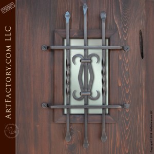

I’d be curious to hear what folks are doing for half-glass doors that afford access to the lock via a broken glass pane in the door. Anything that works there would work for OP as well. The lock enclosure is one idea but not sure I could pull it off in an aesthetically acceptable manner.
If it’s a half glass door and they break the glass part can’t they just climb in that way, like a window?
Its 9 small panes. They can smash all of them plus the frames with some effort but it would be much easier to smash just one and then reach inside to open the lock.
In that case, you just put extra frames or mesh on the inside of the glass. That’s what people do in very high crime areas. There are many styles of these.
However, if they’re doing that, they likely also have similar barriers on the windows. Because it’s fairly rare for a typical US suburban burglar to consider a locked door the weakest point of entry. They’ll check the door to see if it’s unlocked or if the lock is an easy one to open, but then they’ll just move on to a window.
Haha! My father-in-law suggested the same thing! We haven’t found “nice” ones yet but we’ll keep looking.
