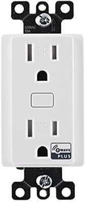

I am doing the same thing with an air conditioner. I use a GE ZWave Outlet, similar to the link below, and a home grown ESP-8266/DHT 11 thermostat - but you can use any ZWave thermostat. Radio Thermostat CT-100 has been around for a while and available on ebay pretty cheap.
