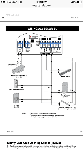

I’m thinking the MIMO may be the way to go. Here’s my wiring diagram. It’s just like a 2 wire garage door button. It’s completes a circuit and opens or closes the gate. Anybody know if low voltage wire like a garage door uses for the open/close button will work over 300 feet?
I’m guessing it will work but it may be susceptible RF noise and that may case the circuit to trigger and open your gate. I would try to put the relay closer to the controller. If you do run it that far use shielded cable (2 conductor plush shield wire) with the shield connected to ground at the controller end and the other end of the shield wire left open.
