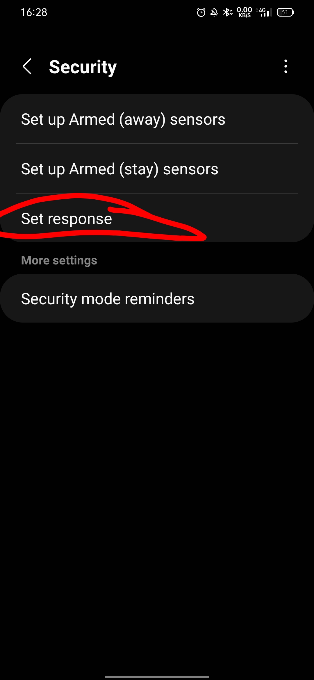

You don’t need nothing for a entry delay, you already have a delay for that, check in your home monitoring for the settings and your security and set response.

oh will try, thanks!
