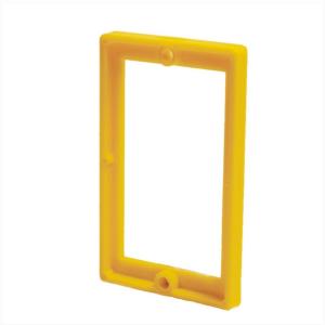

The other option is to use a “collar“ which lets you create a box which sticks up a little bit above the edge of the wall. Then you put a switch plate on that which is designed for that type of installation. The collar is typically called an “extension ring“ even though it is rectangular. :sunglasses:
https://www.kyleswitchplates.com/deep-switch-plate-cover-options-for-protruding-wall-boxes/
So there are some different options.
