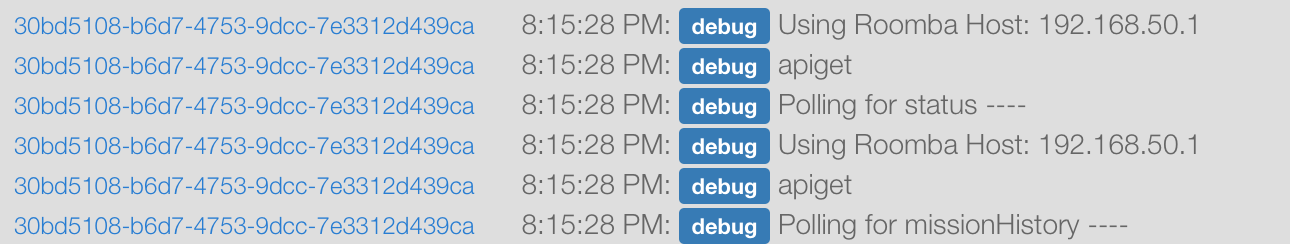

Here’s the problem. I tried inputting a bogus IP address that doesn’t exist for my server, and found that the sendHubCommand still ran my polling, and did not return any sort of error.
The documentation on sendHubCommand isn’t super clear. What should I be doing in order to check the connectivity? How can I make it return an error?

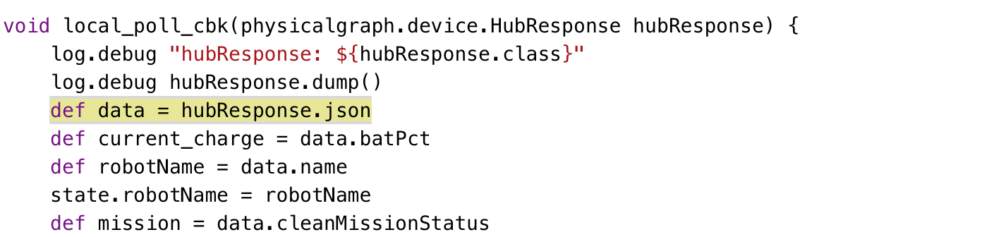

You don’t actually need to change the healthStatus. The way SmartThings works is if no event is received between two ping intervals, it assumes the device is offline. If at anytime it receives an event it marks the device online. So if your device stops responding, just make sure the DTH isn’t sending any events to the platform and it happens for 2 ping intervals it’ll mark the device offline. The point of ping, is to evoke a response (event) from the device. This if your hubresponse doesn’t have any information to report, it shouldn’t send an event and platform should mark it offline.
@RBoy
So in other words if there is no hubresponse I should stop sending sendHubCommand to poll the api? Do I need to include the health check capability for this to work and mark it offline?
