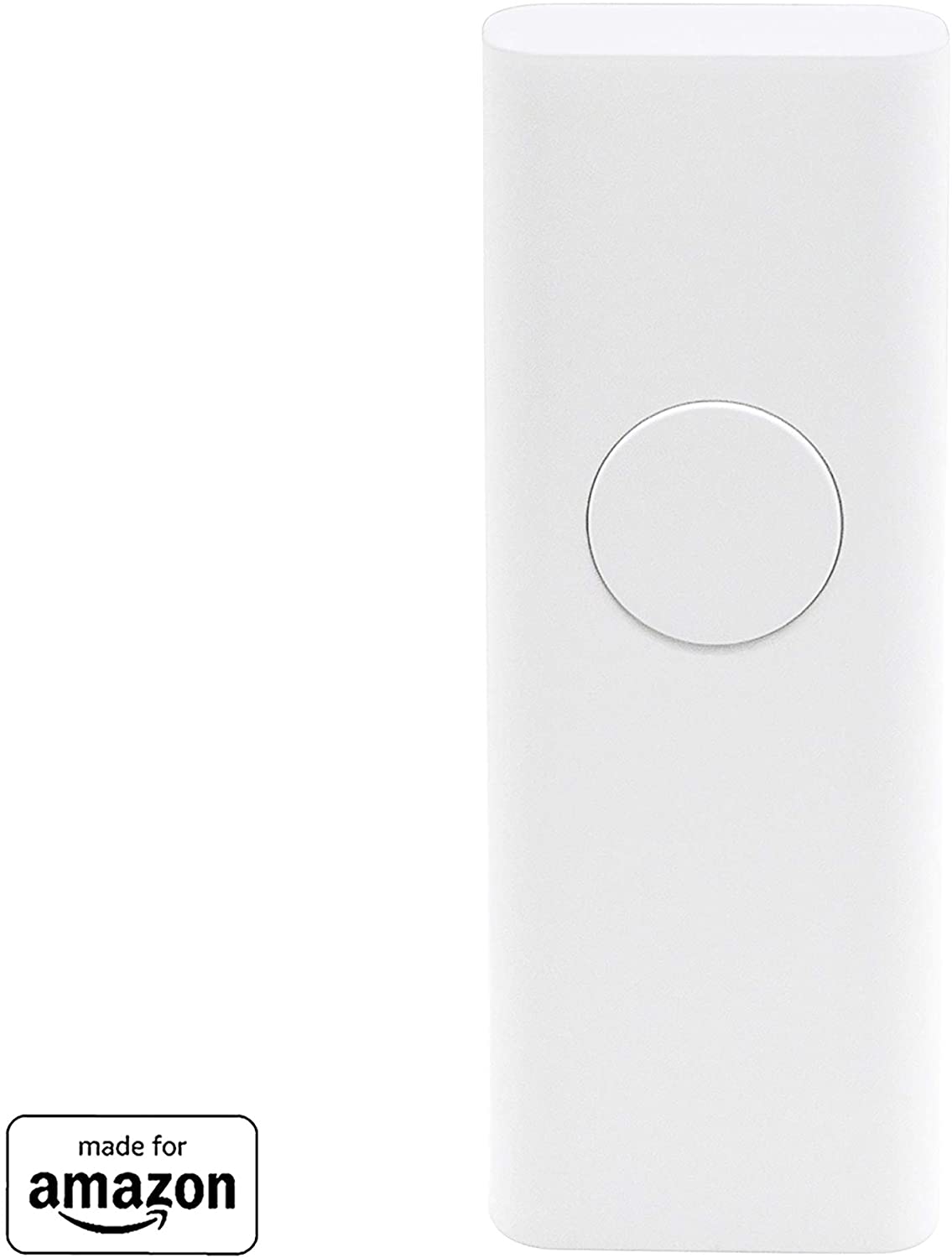

Switch cover or robot finger to physically move your existing dumb switch. These sound a little weird but work fine. They are battery operated devices which sit over the top of the existing rocker or toggle switch and literally move it on or off as requested. I use some of these in my own home. they can be a good solution for when you don’t want to actually replace an existing dumb switch.
These are a little bit noisy when the motor is actually operating. Not as loud as a garbage disposal, but loud enough that a cat will notice it.
There are several brands. This is the one that I use. Note that the current generation is all white, it no longer has the little silver band at the bottom. Otherwise it looks about the same.
