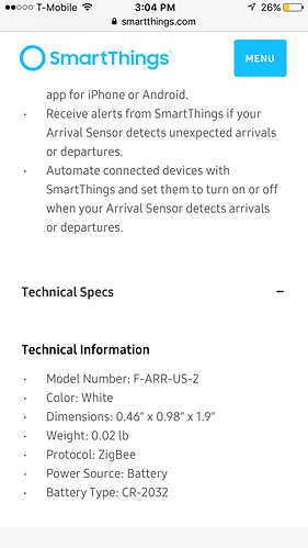

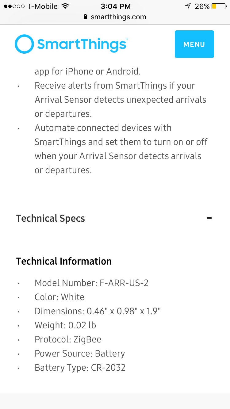

Take screen shot for your records and post here because if it’s advertised then they should issue a refund for the device. I barely get 5 weeks…

The official U.S. Smartthings products page doesn’t mention 2 year battery performance :confused: …was getting ready to ask for refund.
