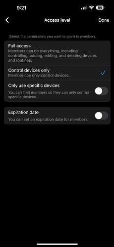

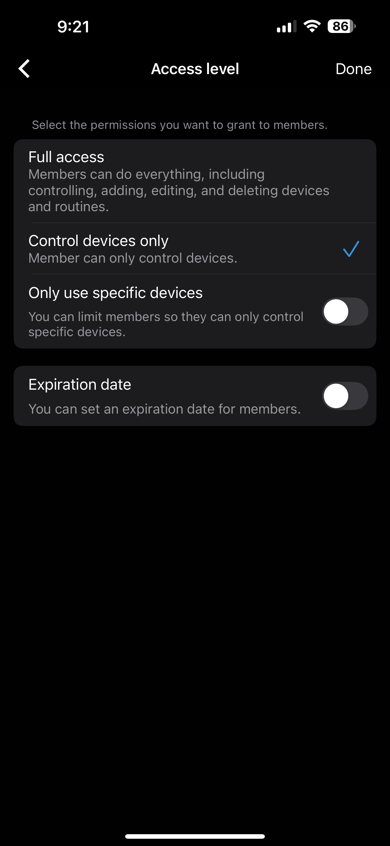

You will get option to give device specific access with expiration date. Load that account to some tablet and leave it guest room.
Is a hub required to create a guest account to access cloud to cloud devices such as Meross?
I don’t think so. You can try. Create guest email, for example jkpguest@gmail.com, and then create Samsung account using google account. Send invite to jkpguest@gmail.com, go to gmail and accept the invite.
Adjust access for guest account and login on guest device with jkpguest@gmail.com account. That is all it takes
You can restrict access to particular devices and Routines that don’t include those devices are not displayed. However, some Routines that don’t include devices but do include changing location mode or setting STHM will be shown.
Since restricted users can’t execute Routines directly, my suggestion would be to create virtual devices to act as triggers for your Routines and make the action(s) for those Routines turning on/off the desired devices. If you have a voice assistant, then your visitors can tell them to turn on/off the virtual control device by name.
