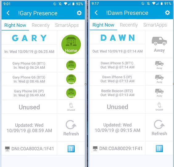

This project consists of two pieces. A Python script with supporting shell script that nominally runs on a Raspberry Pi (tested on 4B and Pi Zero W). This script is configured with people, devices and device addresses to monitor for presence. One person may be associated with up to four devices. All the devices must be “out” for the person to be considered out. Any one device in and the person is considered in.
The second piece is a device handler for SmartThings that receives the information via a JSON file and marks the person’s presence and device status accordingly in SmartThings as shown below.
