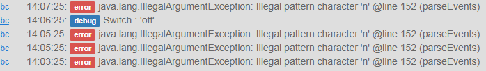

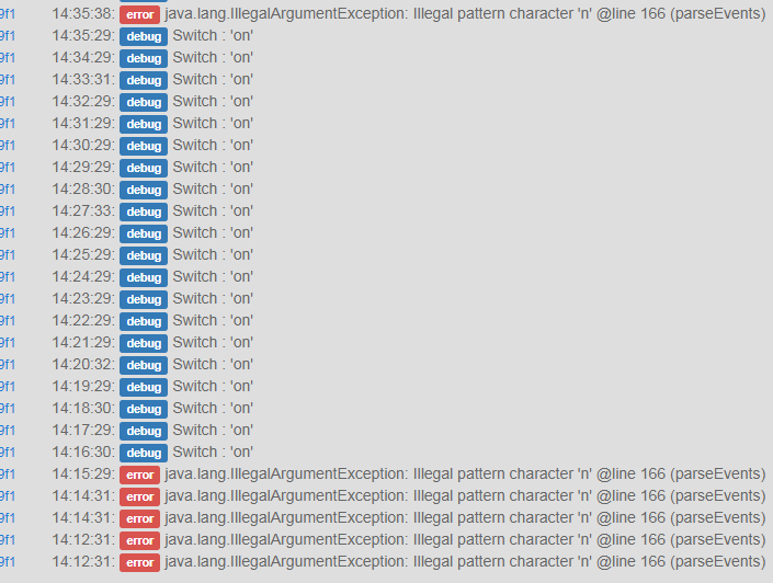

Hi @hongtat, I saw in my IDE many errors like this in the picture. All on Shelly devices with Tasmota (shelly1, shelly 2rgbw, and shelly 1pm) not all, just some, but these errors are repeated cyclically and I don’t know what they could depend on
Can you update the Tasmota Connect codes to the latest (if isn’t), and let me know the device type of the error please.

The error in the shelly1, shelly1pm, shelly PlugS and Shelly rgbw2 (all the type)
I report all the errors found in the log in the last hour, divided by device type. All Tasmota with latest firmware available. If there is anything else I can do to help you identify the problem, ask and I will definitely:
Shelly PlugS
Shelly 1PM
Shelly 1
I hope @hongtat i hope this report will help to understand the origin of theproblem:
From the insertion of the 15th Shelly the errors started, but not only in the last one inserted, but on all the devices already inserted, exactly like the errors indicated in my previous message
I have inserted a total of 28 tasmota devices (25 are Shelly) and the errors appear in the ide exactly as before on all devices.
I notice my devices are not as instantaneous as I hoped, can my delays be linked to these errors?
