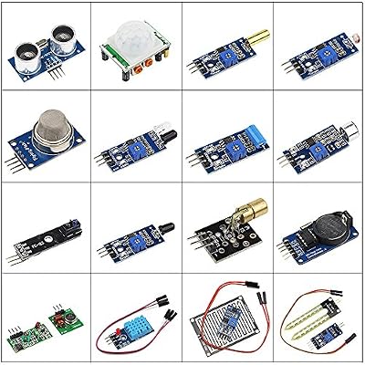

The sensors are the simplest out there pure digital high /low when it moves change the GPIO pin value to high, when it cries change it to high, same with soil if i ever use it :smile: if it poops take it to high …(or low)
Here are the sensors i am interested on (from from top left going right and under) the slot position on the first illustrating picture as follows #2, #7, #8, #14, #16
pretty simple stuff, more to say that i did it rather than utilitarian, if you, or my family for that matter are to lough LOL .

Those sensors should be very easy to implement with OmniThing if they just toggle a gpio. I’ve been meaning to write up some tutorials for using OmniThing, and your project seems like a good example to use.
